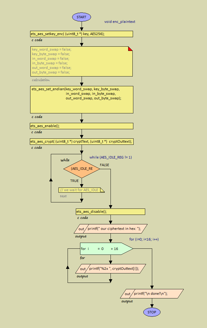

what was done:
we have one task for simple "ping"
and we have one plaintext/cleartext cyphering and one decyphering crypttext
read in the esp32 technical reference manual there is a AES Accelerator chapter.
the functions was found in components folder for esp32, there are headers for ROM, here used ROM/aes256.h
be sure you have change the line for AES_ENDIAN_REG from "ets_set_endian" to "ets_aes_set_endian"
i used for this demo devF .
devF is a Flowchart design programm, that can do flowchart to code, its a flowchart to code generator.
it is a small application for creating program flowchart, source code generation, and compilation.
Its main goal is to be straightforward, educational tool for use during structural programming classes.
devF is freeware and the src code is on github. there comes an own webside for devF and demos for esp asap,
also the links to repo, help, programm leader and so on. btw: devF was written in delphi ;) you can use d7 personal example.
now the AES256 demo:
start with main_app, task, Vars and Function:
here is it:
the enc function:
the dec function:
after we call the code editor and press code generat, we get this code:

 * FunctionName : enc_plaintext
 * Description  : encrypt cleartext to ciphertext
 * Parameters   :
 * Returns      : void
void enc_plaintext()
  ets_aes_setkey_enc( (uint8_t *) key, AES256);
  key_word_swap = false;
  key_byte_swap = false;
  in_word_swap  = false;
  in_byte_swap  = false;
  out_word_swap = false;
  out_byte_swap = false;
  ets_aes_set_endian( key_word_swap, key_byte_swap,
                      in_word_swap, in_byte_swap,
                      out_word_swap, out_byte_swap);
  ets_aes_enable();
  ets_aes_crypt( (uint8_t *) cryptText, (uint8_t *)  cryptOuttext);
  while (AES_IDLE_REG !=1)
    // we wait for AES_IDLE
  ets_aes_disable();
  printf(" our ciphertext in hex: ");
  for (i = 0; i < 16; i++)
    printf("%2x ", cryptOuttext[i]);
  printf("\n done!\n");

you can open the code in browser hereas html side
after press compile, devF calls the "Windows script" from esp-idf, compile and link it.
i used in this demo - single app and bootloader. the menuconfig in esp-idf is amazing!
To flash all build output, must run 'make flash' in devF or on console:
