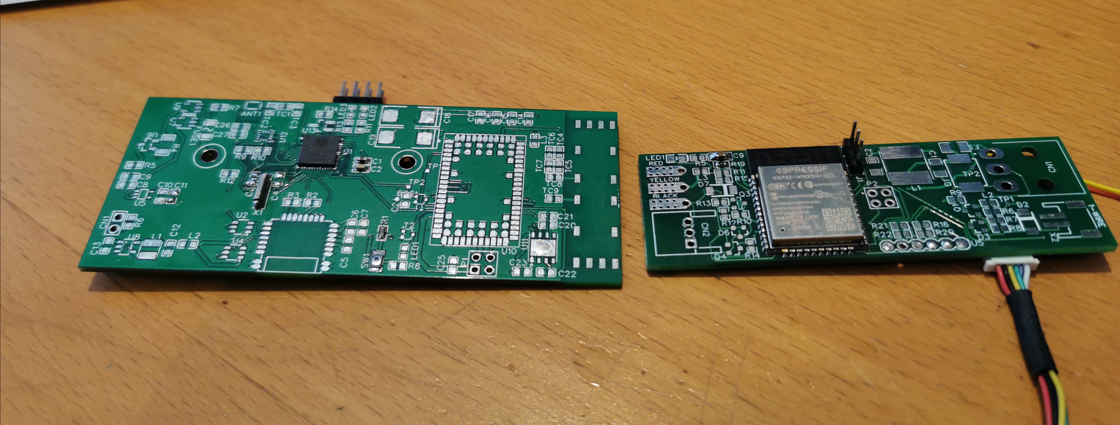

by tabulous
Mon Jul 06, 2020 1:38 pm
Forum: General Discussion
Topic: Low power deep sleep issues WROOM-32 vs PICO-D4 (IDFGH-3624)
Replies: 7
Re: Low power deep sleep issues WROOM-32 vs PICO-D4
Here is the units under test, as you can see these boards are bare, just the modules and some decouple caps.
by tabulous
Mon Jul 06, 2020 10:59 am
Replies: 7
this code give completely differnet results on the above modules.
WROOM-32 deep sleeps at 5uA this is as expected.
PICO-D4 will only deep sleep at 500uA.... !!!!!!
I believe there is a silicon issue on the PICO-D4 ? why would they be so diffferent ?

by tabulous
Thu Jun 25, 2020 11:41 am
Topic: ESP32-PICO-D4 Low Power ?????
Replies: 6
Re: ESP32-PICO-D4 Low Power ?????
So to ensure nothing on my target board can have an effect on the ESP32 current, i've just built another board.
This board only has the ESP32, two de-coupling caps( 10uf, 100nf ) on the VDDA, and a 32Khz crystal(with 12pf CL caps).
I can now see the current is down to 500uA, but this to me is still ...
