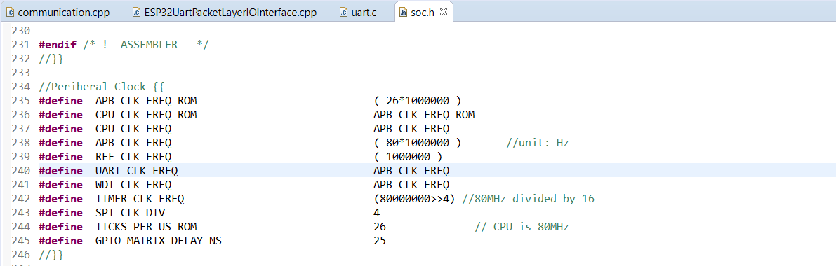

Re: UART clock source
Is it possible to change REF_TICK clock? I can`t find any API to do this.
In the next picture I can see that REF_TICK value is hardcoded in IDF

UART clock source
Hello.
ESP32 communicate with host over UART0 using custom binary protocol with CRC validation.
If I use 200K baudrate, the link is ok. When I increase baud to 1M baud communication is still works, but it is very unstable, very often i get message "CRC invalid". When I sniff data exchange, I saw ...
