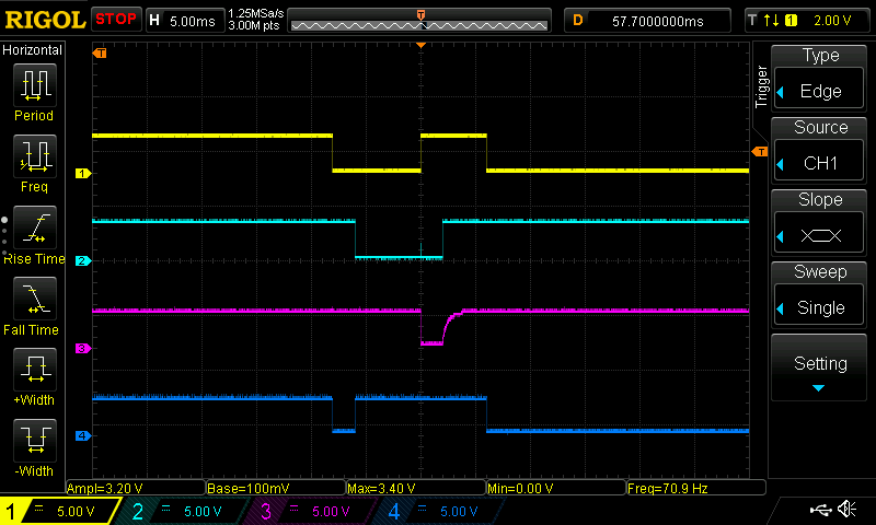

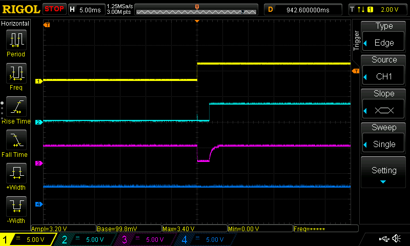

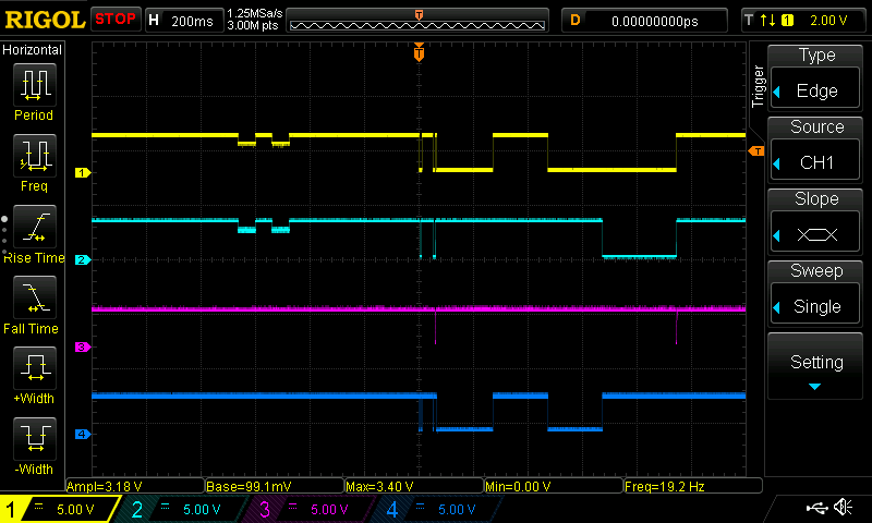

- Mon May 04, 2020 5:37 pm
- Forum: Hardware
- Topic: auto-reset circuit vs continuously running application
- Replies: 5
Re: auto-reset circuit vs continuously running application
Here are screens from my oscilloscope:
DTR - yellow
RTS - cyan
EN - pink
IO0 - blue
It seems EN is pulled low two times during power-up sequence of FT231X.
Would it help to slow down ramp-up of RTS using capacitor?
DTR - yellow
RTS - cyan
EN - pink
IO0 - blue
