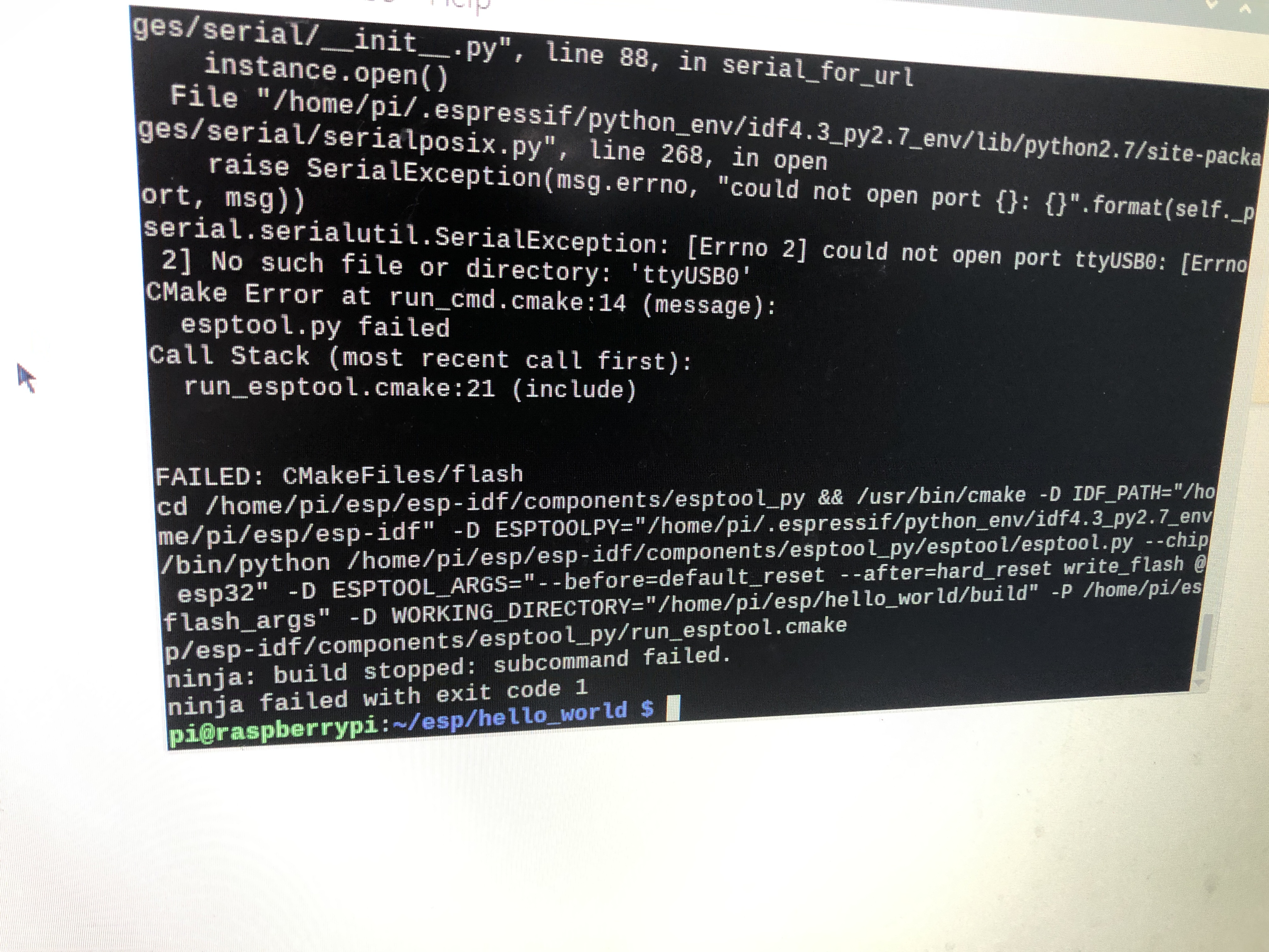

Re: ESP-IDF example flash error on Linux
oh thanks I solve that. I need to type /dev /tty~
thanks for your help !!
thanks for your reply
Yes
I typed "idf.py -p ttyUSB0 flash" and than I faced that error.
Yes
Hi there.
How can I solve this problem?
I've already finished 'idf.py build' but I can't finish 'idf.py -p PORT flash'
