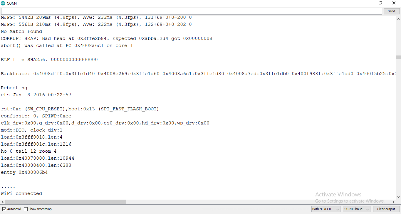

I should have clarified; simply enabling face detection is not enough, a detectable face needs to come into view too.
Thank you so much for your help.
I basically stopped working on that due to some issues. But I'll definitely try your solution.

It doesn't sound like it is likely the problem in this case but always worth checking that the 5 volt supply to the camera is good.
I have found that it needs a very good power supply and if it is not happy with it you can get all sorts of weird errors, behaviour, reboots etc.. I have often forgot ...

Re: ESP32-CAM Rebooting when face detection is activated
Wghat does your serial terminal output before/during/after the reset?
Any idea about the issue?
Hello all,
I'm new to these IoT systems. I was working with the ESP32 Cam module recently and wanted to use it to detect my face and do an action based on my face like opening a door lock or something like that. The issue I'm facing is, after connecting the module to the router and open the window ...
