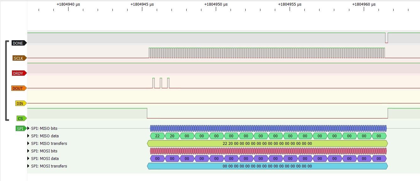

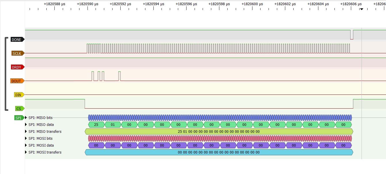

We also tried increasing the number of SCLKs from 96 to 128 cycles by providing the Txbuffer and RxBuffer with length 128bits. But the issue is still observed.
Logical analyzer image showing 0x2501 with 128 clks
Logical analyzer image showing 0x2220 with 128 clks

External ADC ADS131A02 connected through SPI not working
I am using ESP32-WROOMD with cpu clock speed of 240MHz. I have to read the external ADC i.e ADS131a02 from TI in asynchronous slave mode, 32-bit device word, Hamming code word validation off. I should read when i receive an interrupt on DRDY pin, I am using the ESP_INTR_FLAG_EDGE as interrupt flag ...
