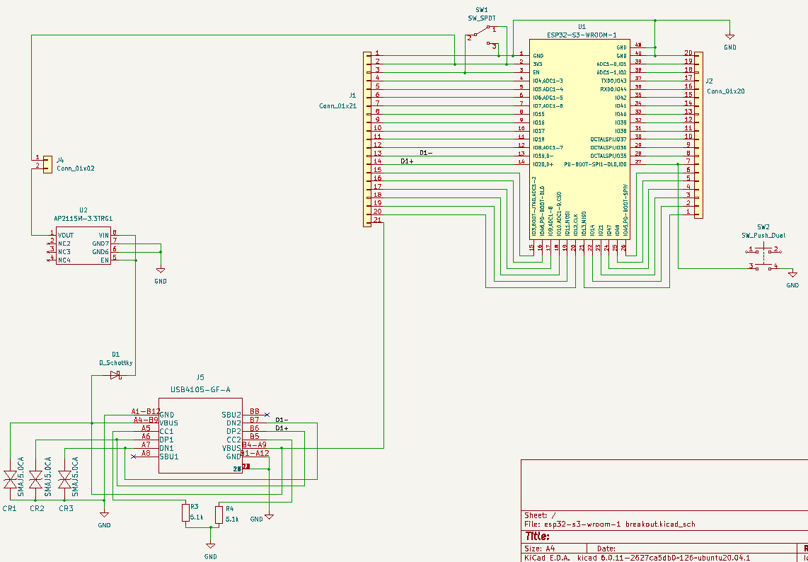

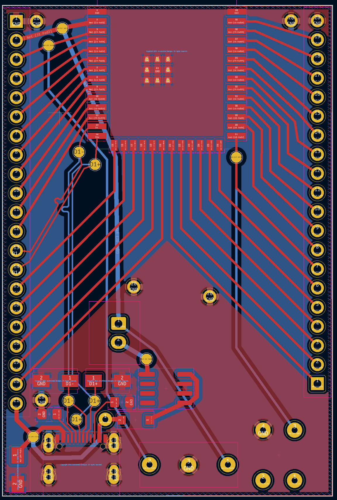

- Mon Apr 17, 2023 2:21 am
- Forum: General Discussion
- Topic: esp32-s3 serial port over usb
- Replies: 9
Re: esp32-s3 serial port over usb
Good point on the caps -- I'll add them. Thanks for taking a look.
- Mon Apr 17, 2023 1:52 am
- Replies: 9
Cool, thanks.
- Sun Apr 16, 2023 10:40 pm
- Replies: 9
My own board design. It's pretty simple - just an ap2115 regulator, a usb4105-gf-a receptacle, a couple of headers, and some buttons for EN and IO0.
- Fri Apr 14, 2023 2:17 am
- Replies: 9
No luck with this.
I reflashed with the menuconfig console output set to USB Serial/JTAG Controller, then plugged in the usb cable, rebooted with GPIO0 grounded. I have verified the sketch is running, but no new ports show up.
I've probed inside the female A end of the cable to verify the ...
