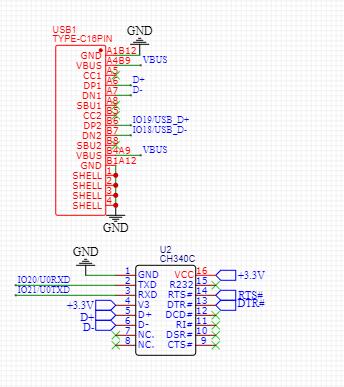

Re: ESP32C3 UART Have no Output
Thanks a lot! I found the Uart0 has been switched by mistake ! Also thanks for pointing the lack of inductance

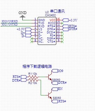

Also, The auto download didn't work properly.[
I designed two functions of type-c, When I switch to USB-CDC it can download normally, But When I switch to UART, it outputs nothing. what's wrong with my design?
