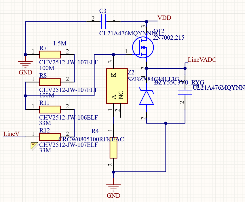

- Topic: ADC reading degrading over time
- Replies: 6
Re: ADC reading degrading over time
The zener, capacitor, and ESP32 share a common ground plane on a 2-layer PCB. The trace from the zener/capacitor junction to GPIO35 is 4mm. There are no other traces running parallel or close to it. There is one trace running perpendicular to it on the underside of the board, but it is a 3.3V pulse ...
- Wed Mar 29, 2023 1:31 pm
- Forum: General Discussion
- Replies: 6
LineVADC is connected to GPIO32
- Tue Mar 28, 2023 9:17 pm
- Replies: 6
I am using GPIO32 as a 12-bit input pin to read a voltage from a sample and hold circuit. I am monitoring the reading with a UART to serial monitor connection. My oscilloscope shows the voltage level does not diminish over time, but the reading from the ESP32 does at a rate of 15 points per minute ...
