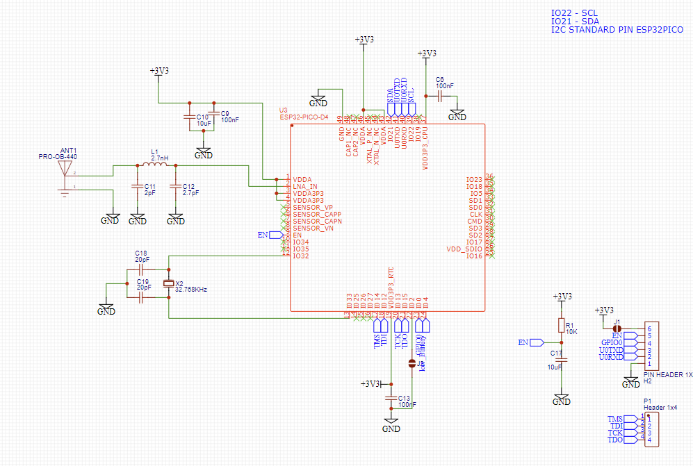

Yep, 3.3V with 10K pull-up and 10uF.Looks like your ESP32 is not booted up. What's the level on EN? 3.3V still stable?
EDIT: Perhaps I'm missing it, but is EN pulled up anywhere now? I still don't see it in the schematic.

Ok,
I revisioned the schematic and added all the necessary fixes. There's also the EN 10uF cap and pullup res onboard now.
I'll route the PCB and see if it works this time around, but the error was anyway quite odd. II suspect it might be on the esp32 side.

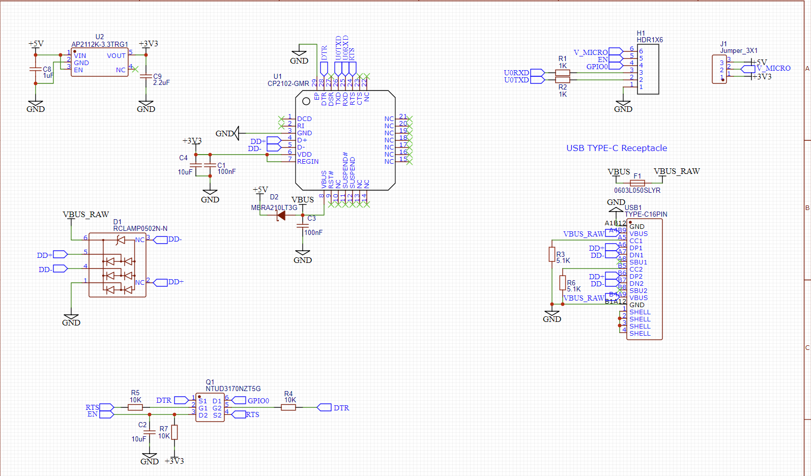

Are you missing a pullup on EN?
Also you need separate 5.1k resistors for each USB CC pin. Raspberry Pi had well-publicised problems sharing the resistor like that.
Hi, thanks for pointing that out.
Yes, I already changed it for the next rev of the PCB. I checked the voltages on the uart bridge ...

Hi, thanks for the reply.
Are you sure about it? They seem ok to me.
I swapped them in the SCH so that I don't have to remember it every time. (I anyway tried to swap them IRL just to double check)
Yes. U0RXD of the ESP32 goes to pin 2 of the header. On the other side, pin 2 of the header is ...

You swapped U0TXD and U0RXD twice, meaning the Rx of your serial-USB chip is connected to the Rx of the ESP32.
I swapped them in the SCH so that I don't have to remember it every time. (I anyway tried to swap them IRL just to ...

ESP32-PICO-V3 won't go in download mode
Hi all,
I've designed a very simple board using the esp32-pico-v3 and an external flasher using a CP2102.
when I try to flash anything, I get this error:
