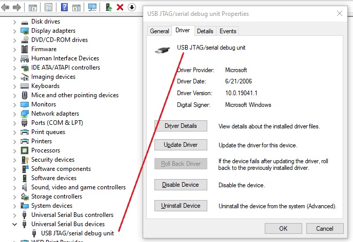

Re: ESP32 built in USB-to-JTAG debugger - HELP
It was the driver.
The 2021 driver can be found here
https://dl.espressif.com/dl/idf-driver/ ... -07-15.zip
While the OpenOCD Server is now running, it is reporting errors. More debug required

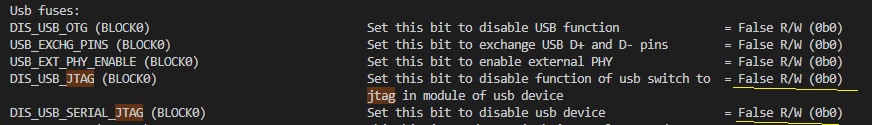

There are two ESP32 efuses which can disable the USB/JTAG interface, both are set to not disable the function:
Is this a driver issue? Notice the age of this driver, 19 years old....can this be the right driver?

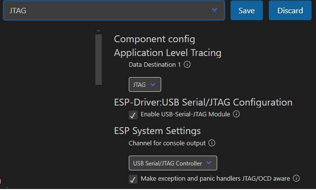

This is the menuconfig JTAG settings
