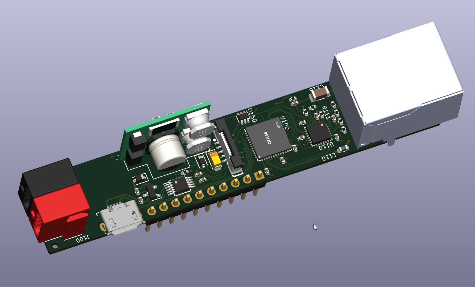

I wanted to add, I use the Pico-V3-02 + LAN8720 because it is a VERY compact solution and I have not much board space.
Thats it how it should look like when layouted in final form factor..

I made a custom board with the PICO-V3-02 that should have wired Ethernet. I choose Lan8720 for that purpose.
While I'm new into using ESP32 I choose to make a evboard with a lot Jumpers so I can learn first and more easily try things out.
I already learned about some basic mistakes I made in ...
