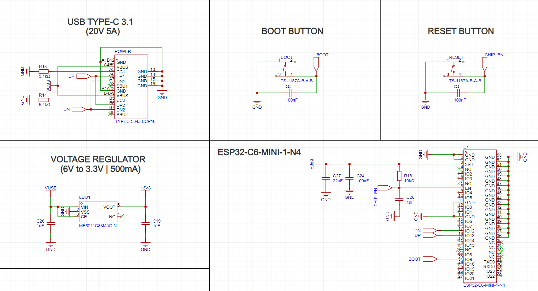

I really did miss GPIO8. Thank you very much for your help! 🙏

ESP32-C6-MINI-1 USB connection problem
Hi everyone,
I’ve been working on this schematic diagram and would love to get some feedback. Does anyone spot any errors or mistakes that I might have missed? I’d really appreciate any suggestions or improvements!
Thanks in advance!
