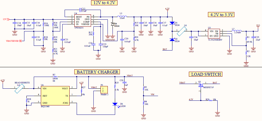

Re: Device hang when switch power supply
Thanks,
We have using CPH6341 MOSFET. We have tried as you told(remove MOSFET circuit) then check the process.But our TLV chip has blown-out.
Regards,
Kishan Patel.
Regards,
Kishan Patel.
Yeah sure.I have attached schematic image of power supply.
Thanks.
Thanks.
I have used MOSFET.When i remove 12 volt,device has hangup.If i again give 12 volt when device has working on backup battery,there is no issue.But when remove 12 volt,sometimes Brownout reset occur and sometimes device has hang.
Thanks.
Thanks.
Actually,i am using 2 type power sources with esp-wrrom32 module.
One is 12 volt dc supply and another is 3.7 volt(back_up battery purpose).
Problem which i have facing is that when i try to switch power supply,sometimes device will detect Brownout and reset,then start application as it is ...
