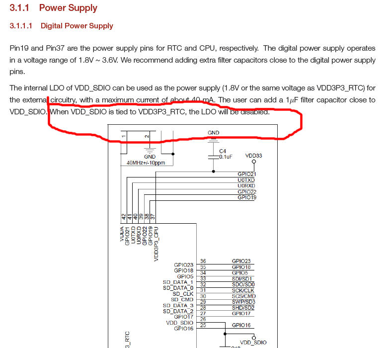

Screenshot:

Re: Disable VDD_SDIO -- ESP32-D2WD
Okay, I'm confused now. I'm just going off what the datasheet says... I'm using the D2WD, so I was going to leave VDD_SDIO floating.
I understand VDD_SDIO is a 1.8V power rail, right?
Is VDD3P3_RTC a power rail, or a power input for the RTC?
The datasheet says to tie VDD_SDIO to VDD3P3_RTC to ...
