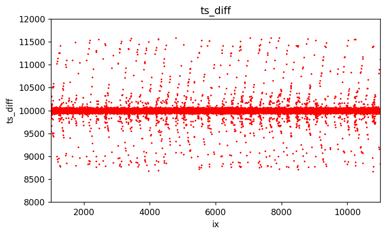

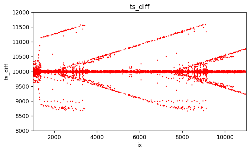

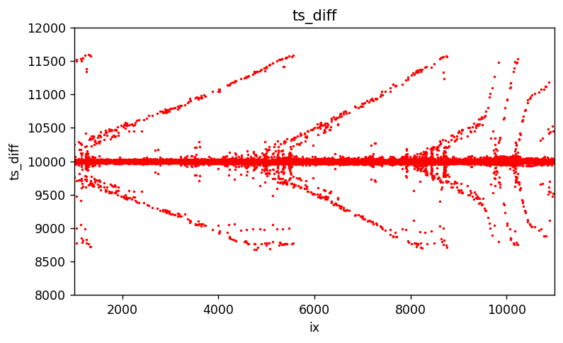

Re: Increasing RTOS Tick Rate, >1000Hz
So I screwed up the X axis (damn lies and statistics, and whatnot)
Still logging at 100Hz, here's the timestamp variation at the various tick rates with the proper/normalized X axis
CONFIG_FREERTOS_HZ=50 CONFIG_FREERTOS_HZ=100 CONFIG_FREERTOS_HZ=1000
