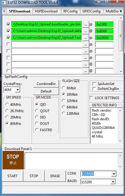

Re: ESP32 Flash Download Tool produces "flash read err, 1000" on boot
Dear Angus,
The problem is solved...now its working ...
After enable Verbose... watch the compile process...
then upload as per memory locations...
Thanks for your support...

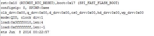

Hi Angus,
I change the SPI mode to DIO for bootloader_qio.bin...
After reset the device, it shows that ....
and also i tried bootloader.bin in DIO mode ...
rst:0x1 (POWERON_RESET),boot:0x17 (SPI_FAST_FLASH_BOOT)
configsip: 0, SPIWP:0xee
clk_drv:0x00,q_drv:0x00,d_drv:0x00,cs0_drv:0x00,hd_drv:0x00 ...
Hi Angus,
Thanks for your reply.
I test as per your reference.
Flash -QIO - bootloader_qio.bin for 0x1000
partitions -> default.bin for 0x8000
.bin of source for 0x10000
After programming it show
kindly give any other solution ...
1. Develop the code using Arduino
2.Change output format(.ino) into (.bin).
3.select esp32 flash download tool shown in image below. Esp32_Flash.JPG Esp32_Flash.JPG
4.upload the code,it will loading then finally it shows "FINISH".
5.After then reset the module it shows the error
rst:0x1 (POWERON ...
