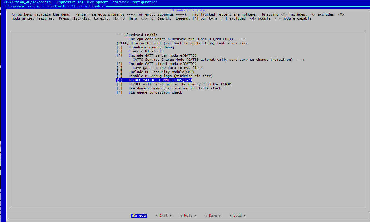

Re: Hello forum. A beginner question
I believe the IDF supports up to 7 connections. It is an option the the "make menuconfig"
