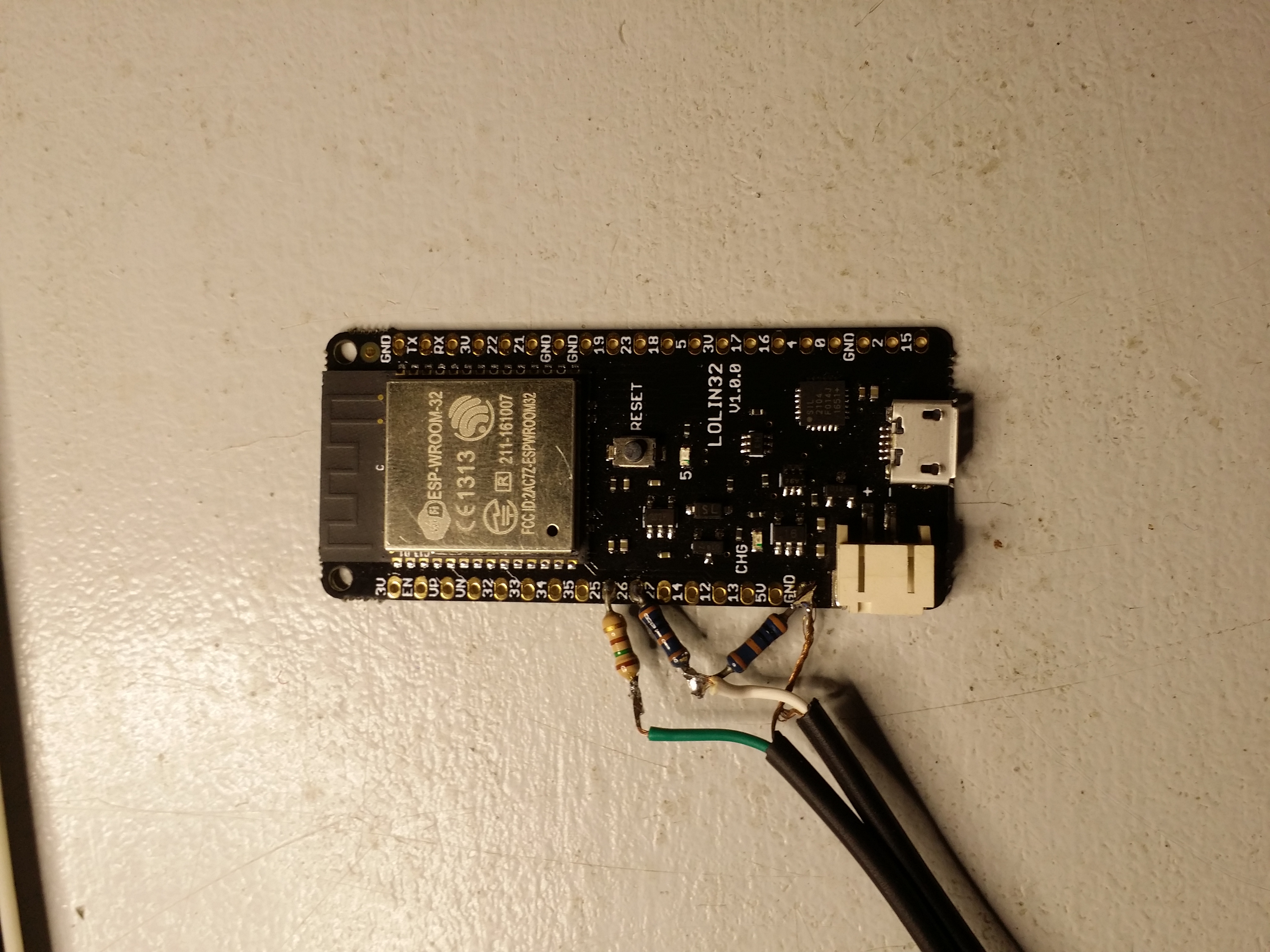

Hi
Tried it with an LOLIN32 v.1.0.0 board but I got no signal on the outputs (Checked with oscilloscope).
Here's the output from the flashing:
c:\Users\Jimmy\OneDrive\holidays2017>python c:\esp-idf\components\esptool_py\esptool\esptool.py --port com7 --baud 230400 write_flash 0 holidays2017.bin
esptool.py v2.1
Connecting....
Detecting chip type... ESP32
Chip is ESP32D0WDQ6 (revision 0)
Uploading stub...
Running stub...
Stub running...
Changing baud rate to 230400
Changed.
Configuring flash size...
Auto-detected Flash size: 4MB
Compressed 3145728 bytes to 1802179...
Wrote 3145728 bytes (1802179 compressed) at 0x00000000 in 80.7 seconds (effective 311.8 kbit/s)...
Hash of data verified.
Leaving...
Hard resetting...
Can't find anything strange in that.
Here's is a picture from my quick-and-dirty build:
Any ideas?

Posts: 10636
Re: Happy Holidays! (W/ binary for your ESP32!)
Postby Sprite » Sat Dec 30, 2017 2:29 pm
Huh, I can replicate this... I have one DevkitC with a rev0 ESP32, but also different flash; it also crashes. My rev1 DevkitC with stock flashchip just works. Will see if I can fix this.
Edit: Looks like I broke the rev0 compatibility with a last-minute modification... not sure if I'm going to be able to code rev0 compatibility in there again, although I'll surely try.

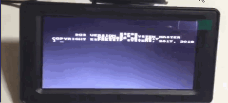

ta-mat
Posts: 12
Joined: Thu Dec 21, 2017 4:07 pm
Postby ta-mat » Sat Dec 30, 2017 3:24 pm
Hey, videos and sounds are working fine here :)
Happy Holidays!
P.S. Scrollers and Trackers forever!!
