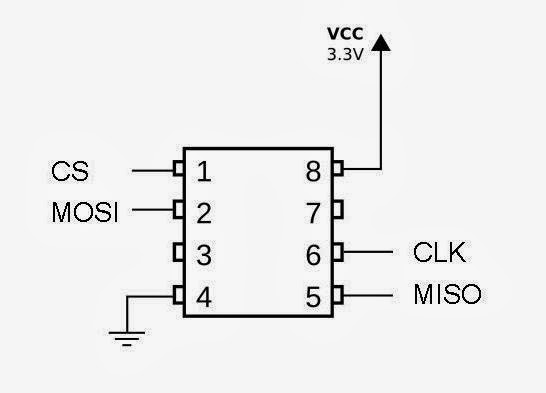

you can use usually SPI ( Master ) for thisHi,The MMU in the ESP32 is incapable of putting 2 devices in the same memory space, so 'adding' memory to the internal memory is not going to be possible. You can connect the flash to a 'normal' SPI peripheral and use it as a SPI device where you can store 'plain' data in the same way you can use an SD-card to do that. Alternatively, you can burn the ESP32 fuses to let it use different GPIO pins for the main flash and connect your 16MiB flash there; that way it will be used instead of the 4MiB flash in the WROOM chip.
Thanks for reply.
Would you please send me configurations and examples to use external SPI Flash memory like SD Card?
SPI
MOSI
MISO
CLK CS
read the datasheet from your favority SPI Flash, there are "commands" for read and write and erase and protections
if you use SD Card too in the lines, you need a different /CS Pin from GPIO
SPI Flash simple connect ( example 3.3V ) :
pullups / pulldowns take from your HW design
have a look to storages examples too.
example wear_levelling
then you need knowledge about espefusesIf I want to use 16 MB external SPI Flash memory as main memory then ...
this is your start..how I can do it and what are hardware + software changes are required to make it?

Wrover "system" Flash is 1.8V and pSRAM also is 1.8V and they supply from VDD_SDIO domain,
that have boostrap MTDI ( IO12 ) - done in the wrover modul.
if you want use "deep sleep" and you connect "extern spi flash" or "extern system flash" and efused this,
note, that VDD_SDIO is not breakout from wrover modul.
if you want use 1.8V extern flash you need regulator 1.8 or "wire" from SoC.
think over your conzept detailed what you want to do.
btw
i changed in the past the 1.8 V pSRAM and 1.8V Flash gen 3v3 pRSAM and Flash
and yes, then Bootstrap must be low done by user for VDD_SDIO 3V3
