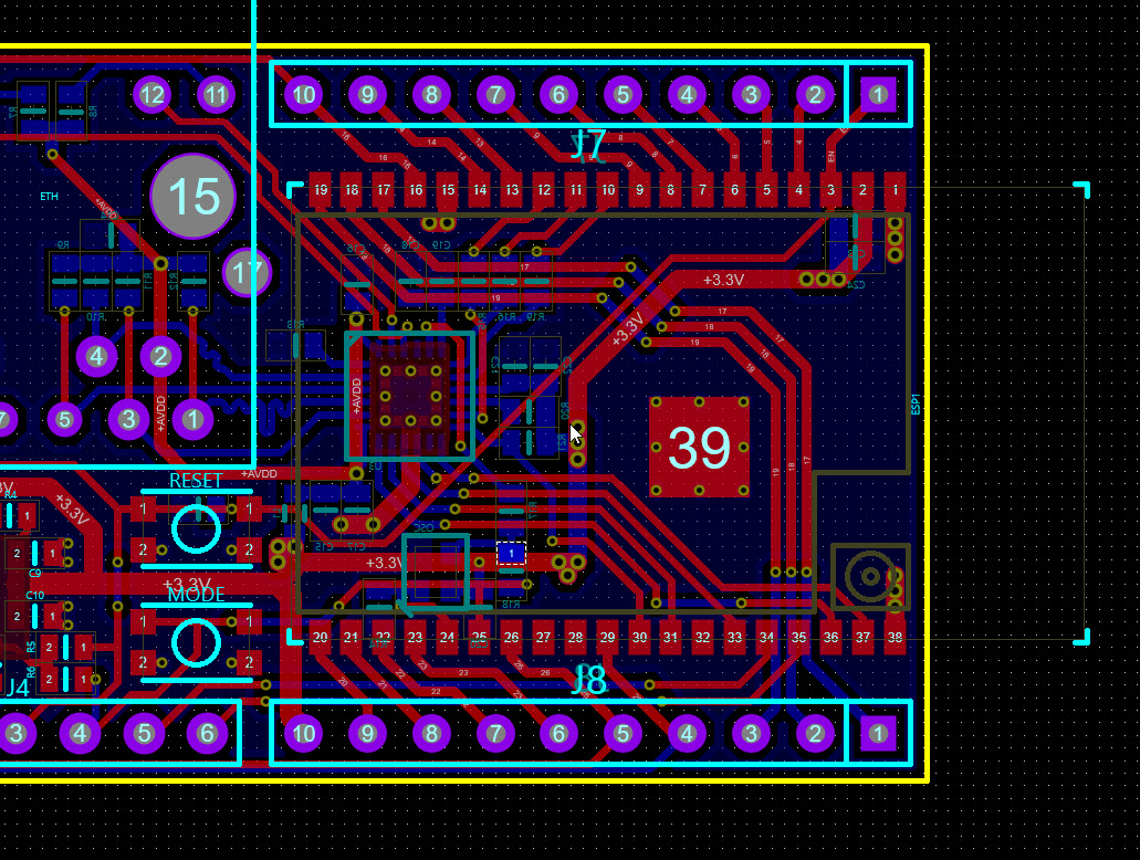

I am designing PCB to be used on quadcopters. It should. include following:
  • ESP32-WROOM-32U (4 MB flash variant)
  • new ICM-20689 accel & gyro sensor
  • MS5611 barometer
  • external 128 Mbit SPI flash
  • JTAG connector
  • CP2102N USB-UART converter (24 or 28 pin variant)
Barometer and SPI flash will share VSPI bus. I will probably use 4 layer PCB. HW design guidelines paper says following:
  • 1st layer signal traces + components
  • 2nd layer GND plane
  • 3rd layer 3.3V plane + some signal traces
  • 4th layer power traces only
It is not recommended to place any components on bottom 4th layer.
Unfortunatelly I need to place barometer (and probably some other components due to size limitations) on the bottom layer. So I am thinking of using this scheme:
  • 1st layer traces + components
  • 3rd layer 3.3V plane + few necessary signal traces
  • 4th layer traces + components
Is this ok? Is it ok to place components on the bottom layer under the ESP32 module with making sure that there is a complete GND plane under ESP32? Do you have any other suggestions?

I am only using 2 layers and placed a PHY IC under it, with quite a few other parts. Works no problem. If your using 4 layers there should be no issue at all.

Thank you for your answer. I have also seen that ESP32 DevKitC uses AMS1117 LDO regulator. I would like to use it as well. AMS1117 datasheet recommends to use 22 uF tantalum capacitors but DevKitC uses ceramic ones.
I would like to reduce noise on the power trace as much as possible. I have read that noise on the power trace can cause noise on the gyro data. I am thinking about adding one separate AMS1117 just for the gyro. What do you think about that?
  • 4th layer GND plane
  • 5th layer traces + components
Connect 2nd and 4th
michprev
Posts: 92
Joined: Fri Aug 04, 2017 8:57 pm
Re: Quadcopter PCB design tips
Postby michprev » Tue Aug 28, 2018 4:45 pm
Connect 2nd and 4th
5 layer PCBs are not standardly used :lol: and 6 layers are unnecessarily expensive

But you get perfect noise reduction for the price cost of course )
