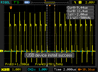

I encountered another major problem. Assigning a single byte to an array element takes about 7 µs! Is there a more optimal way to store a 27-byte block faster?
uint8_t read_buffer[27] = {0};
		for(int i = 0; i < 27; i++) {
			REG_WRITE(RTC_GPIO_OUT_W1TS_REG, (BIT(CLK_PIN) << RTC_GPIO_OUT_DATA_W1TS_S)); REG_WRITE(RTC_GPIO_OUT_W1TC_REG, (BIT(CLK_PIN) << RTC_GPIO_OUT_DATA_W1TC_S));
			byte1 |= (uint8_t)(((REG_READ(RTC_GPIO_IN_REG) >> RTC_GPIO_IN_NEXT_S) & BIT(DATA_PIN))  / 4);
			byte1 |= (uint8_t)(((REG_READ(RTC_GPIO_IN_REG) >> RTC_GPIO_IN_NEXT_S) & BIT(DATA_PIN))  / 2);
			byte1 |= (uint8_t)(((REG_READ(RTC_GPIO_IN_REG) >> RTC_GPIO_IN_NEXT_S) & BIT(DATA_PIN)));
			byte1 |= (uint8_t)(((REG_READ(RTC_GPIO_IN_REG) >> RTC_GPIO_IN_NEXT_S) & BIT(DATA_PIN)) * 2);
			byte1 |= (uint8_t)(((REG_READ(RTC_GPIO_IN_REG) >> RTC_GPIO_IN_NEXT_S) & BIT(DATA_PIN))  * 4);
			byte1 |= (uint8_t)(((REG_READ(RTC_GPIO_IN_REG) >> RTC_GPIO_IN_NEXT_S) & BIT(DATA_PIN)) * 8);
			byte1 |= (uint8_t)(((REG_READ(RTC_GPIO_IN_REG) >> RTC_GPIO_IN_NEXT_S) & BIT(DATA_PIN)) * 16);
			byte1 |= (uint8_t)(((REG_READ(RTC_GPIO_IN_REG) >> RTC_GPIO_IN_NEXT_S) & BIT(DATA_PIN)) * 32);
			read_buffer[i] = byte1;
Without assigning a value to an array.png (12.13 KiB) Viewed 4927 times
Pause caused by assigning a value to an array.png (9.38 KiB) Viewed 4927 times

Postby MicroController » Sun Feb 02, 2025 11:54 am
Use one 32-bit store instead of four 8-bit stores.
Also worth trying: Iterating over the array via a pointer.

Postby Honzik321 » Sun Feb 02, 2025 2:07 pm
This code gives almost the same time for reading 28 bytes of data (even a few microseconds more than the previous code). I have no more ideas :-( I need to read 28 bytes of data under 500 µs, which is very close—right now, it takes about 530 µs.
	uint32_t read_buffer1[28] = {0};

Postby MicroController » Sun Feb 02, 2025 6:33 pm
The fastest way to iterate over an array "via a pointer" is usually:
static const unsigned int MY_ARRAY_NUM_ELEMENTS = sizeof(my_array)/sizeof(my_array[0]));
uint32_t* ptr = &my_array[0];
uint32_t* const end = ptr + MY_ARRAY_NUM_ELEMENTS;
do {
  *ptr = ...;
  ptr += 1;
} while (ptr < end);
(Though gcc sometimes decides to "optimize" this back to a for-loop with an explicit index.)
Unrolling the loop and using literals for subscripts is still faster.
And collecting (up to) 32 bits is fastest like
uint32_t bits = 0;
do {
  bits = (bits << 1) | nextBit;
} while(...);

Thank you for the tips! I tested all possibilities and combinations of data reading by uint8_t, uint16_t, and uint32_t types. Unfortunately, I couldn't achieve faster reading. Using a 32-bit array can speed up the process by approximately 10%, but at the cost of irregular bit lengths. I decided to stick with a uint8_t array and load data in 8-bit chunks. There is always a gap of approximately 9 µs between individual bytes, in which case the CLK for each byte is regular with a frequency of approximately 600 kHz.

At this level, you'd probably want to look at the assembly output as well; it will probably give you some more clues on how to optimize things.

Sorry for the late reply. At the moment, the achieved SPI transfer speed using bit-banging is sufficient for reading data from two SPI slave devices every 2 ms (500 samples per second). My original goal was 1 kSPS, but this will probably not be achievable.
Below, I am sending the complete code for the ULP coprocessor (created from the example project ULP => interrupts). I shifts the bits immediately when reading a byte and the DATA (MISO) is on pin 0, as this solution gave me the best results. It also didn’t matter whether I used a pointer or assigned data to an array using an index. Optimization didn't matter; `0s` or `02` gives the same result. The result is reading from two SPI slave devices into two ping-pong buffers of 1350 bytes each, allowing one buffer to be processed while the other is being filled with data.
