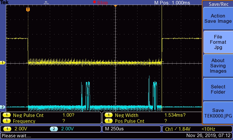

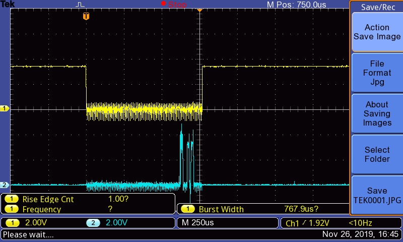

I am developing my own i2s paralle 8 bits with dma library(static allocation memory).
When i write to the parallel port using only one descriptor(4092 uint8_t), the clock time to send, for example, 1000 uint8_t at 10 MHz is 100 microseconds(1000/10 000 000).
Apparently all ok with only one descriptor.
When i use more than one descriptor, the clock time to send, for example, 7680 uint8_t at 10 MHz is 1536 microseconds.
Should be half of this value 768 microseconds( 7680 / 10 000 000 ). I don't know why it's taking twice as long.
In annex follow an oscilloscope image of 7680 uint8_t at 10 MHz.
The yellow waveform are the clock(10MHz).
The blue waveform are the D0 channel data.
I initialize the buffer with zeros, but in D0 channel appears some weird data.

Smells like you're filling the DMA descriptor wrong, but you're not including that code...

Hi ESP_Sprite,
Follow the code you commented.

        return 3;  // Com input parameter length = 4093 -> 1.47 us. Com input parameter length = 30720 -> 4.7 us.

Now i add the following instructions:
* fifo_tx_reset( );
* dma_tx_reset( );
Besides:
* tx_reset( );
static void fifo_tx_reset( )
    I2SX.conf.tx_fifo_reset = 1;    // Set this bit to reset the transmit FIFO. (R/W)
    I2SX.conf.tx_fifo_reset = 0;
static void dma_tx_reset( )
    I2SX.lc_conf.out_rst = 1;    // Set this bit to reset out DMA FSM. (R/W)
    I2SX.lc_conf.out_rst = 0;    // FSM = Finite State Machine.
int i2s_lcd_write_data ( uint32_t length, bool buffer_id )  // length = numero de bytes. length <= 7680.
    static uint32_t i;
    static uint8_t* ptr = NULL;
    if ( length > buffer_size/4  )    // Length > buffer capacity. Usar printf. buffer_size/4 = 30720/4 = 7680 bytes.
        printf( "error: length > buffer_size/4.\n\n" );
        return -1;
    if ( buffer_id == 0 )
        ptr = (uint8_t *) &buffer_a;    // buffer_a é uint16_t.
        for ( i = 0 ; i < length ; i = i + 2 )    // length <= 7680 bytes.  loop no maximo 7680/2 = 3840 vezes.
            buf_a[ i ] = ptr[ i ]; // o endereco de buf_a incrementa em 4 bytes enquanto o endereco de buffer_a(ptr) inc em 1 byte.
            buf_a[ i + 1 ] = ptr[ i + 1 ];
        fill_dma_descriptor_a( (uint32_t) 4 * length );  // ( 4 * length ) = converte de byte(8 bits) para word(32bits).
        I2SX.out_link.addr = (uint32_t) &dma_desc_buf_a[0];
    else
        ptr = (uint8_t *) &buffer_b;    // buffer_a é uint16_t.
            buf_b[ i ] = ptr[ i ];    // o endereco de buf_a incrementa em 4 bytes enquanto o endereco de buffer_a(ptr) inc em 1 byte.
            buf_b[ i + 1 ] = ptr[ i + 1 ];
        fill_dma_descriptor_b( (uint32_t) 4 * length );    // fill_dma_descriptor_b( length );
        I2SX.out_link.addr = (uint32_t) &dma_desc_buf_b[0];
    I2SX.out_link.start = 1;       // Set this bit to start outlink descriptor. (R/W).
    I2SX.fifo_conf.dscr_en = 1;    // Set this bit to enable I2S DMA mode. (R/W).
    I2SX.conf.tx_start = 1;        // Set this bit to start transmitting data. (R/W).
    if ( I2SX.int_st.out_dscr_err )
        printf( "Dma error, interrupt status: 0x%08x", I2SX.int_st.val );
    while ( ! ( I2SX.state.tx_idle ) )   // The status bit of the transmitter. 1: the transmitter is idle. 0: the transmitter is busy.(RO)
    I2SX.conf.tx_start = 0;    // Set this bit to start transmitting data. (R/W).
    tx_reset( );           // Set this bit to reset the transmitter. (R/W)
    fifo_tx_reset( );
    dma_tx_reset( );
    I2SX.fifo_conf.dscr_en = 0;    // Set this bit to enable I2S DMA mode. (R/W).
    return 2019;
Now when use more than one descriptor, the clock time to send, for example, 7680 uint8_t at 10 MHz is
The time is correct now, but only send one time and stop.
Also in the D0 channel appears some weird data yet.
Do i need to reset ahb bus or something like that ?
I will try.

I used only the function below to isolate the above behavior.
* dma_tx_reset( );
With the function
fifo_tx_reset( );
the time error remained(1536 us).
