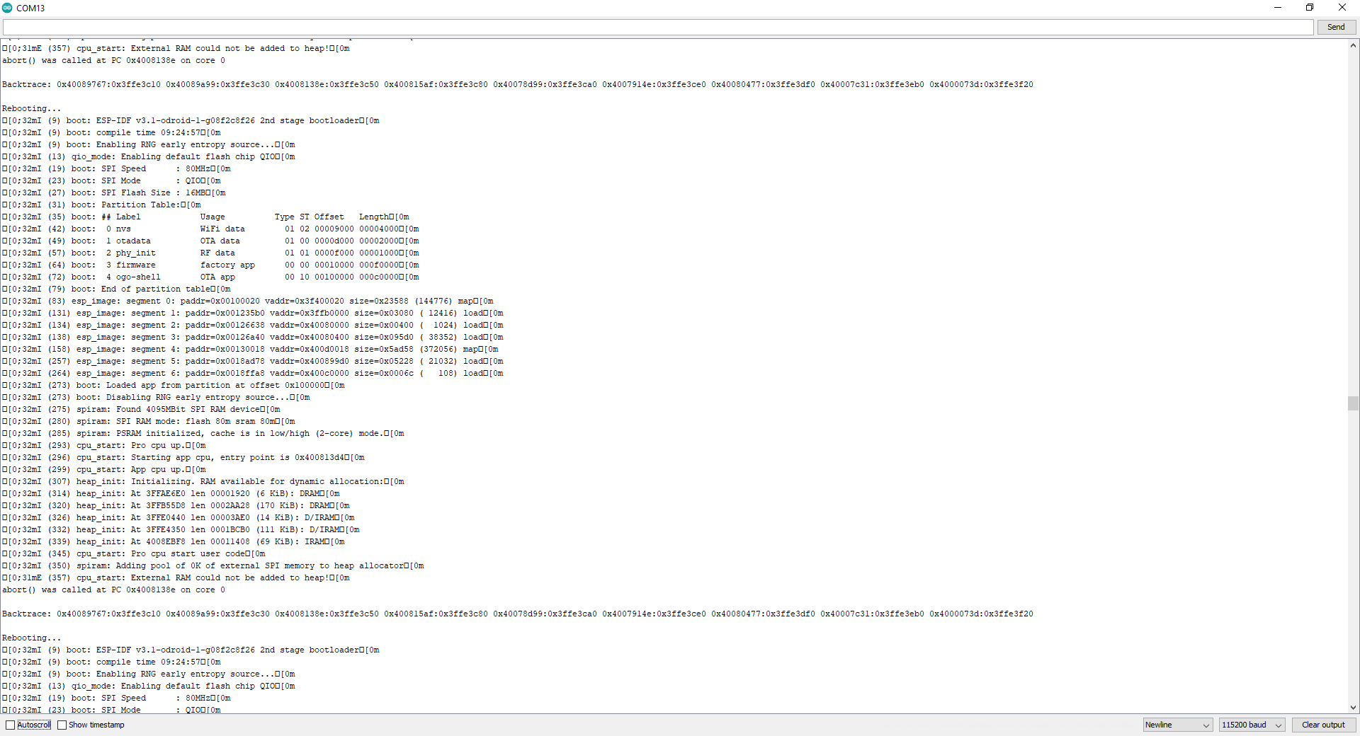

I have hardware design based around ESP32 and SD card(among others). User selects application from SD card that preloads into ESP32. The problem is that some apps don't start because they can't initialize external PSRAM, others that don't use external PSRAM work fine. There is UART output attached.

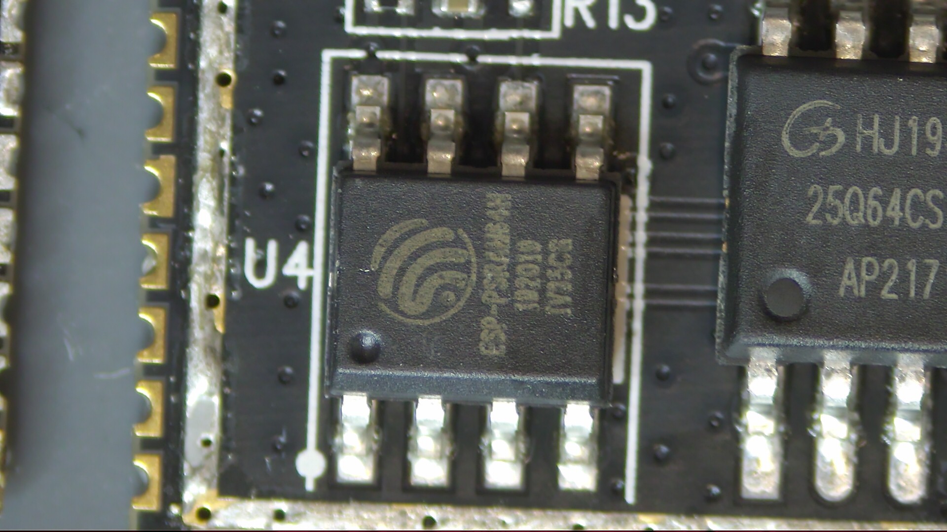

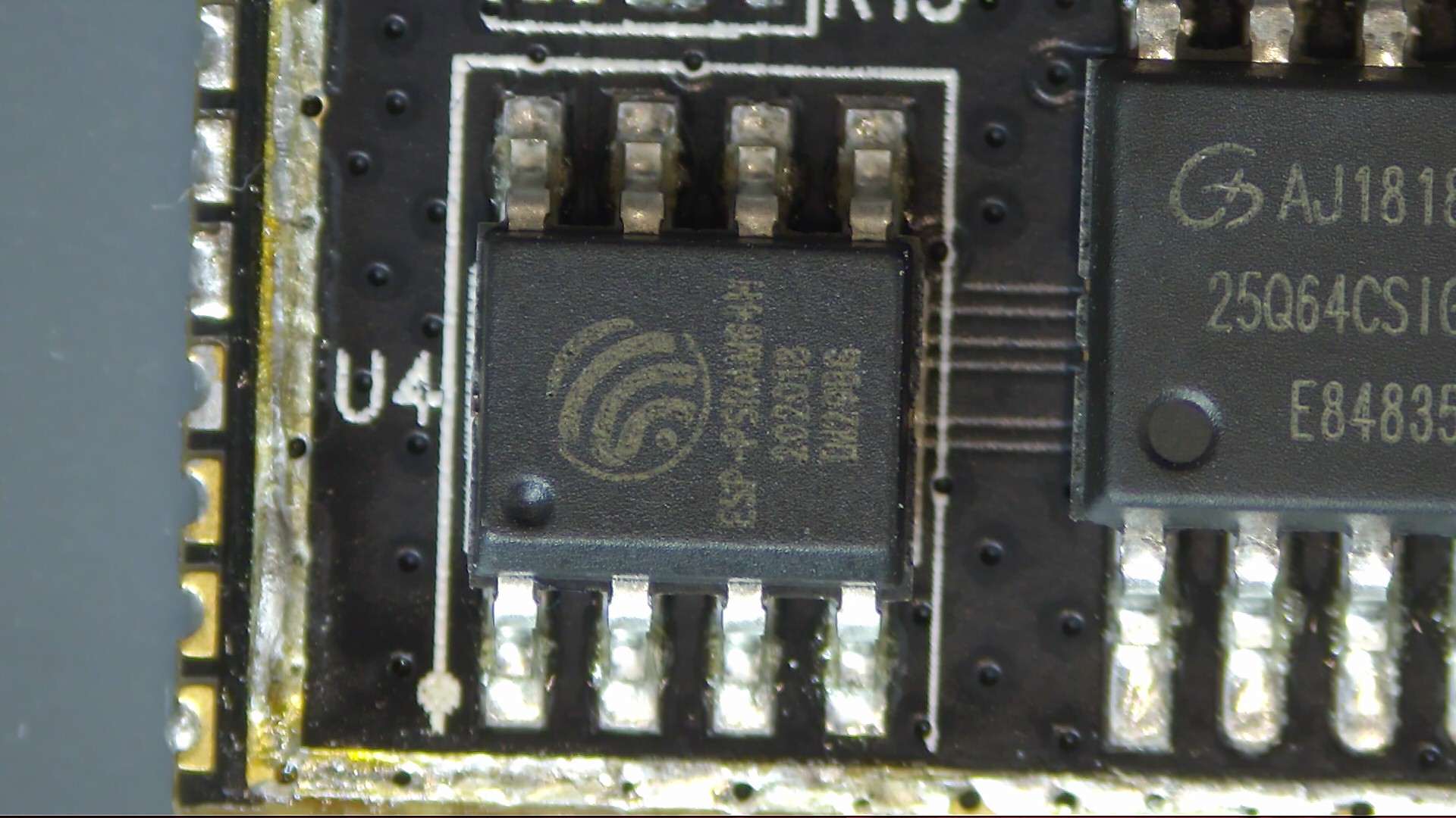

The problem is that I have two batches of ESP32 modules. Old from TME.com and new from digikey.com. On old batch everything works fine(PSRAM initializes), but on new it fails to do so. Hardware(PCB) and software is identical for New and Old batch. There are pics of old and new batch modules, old modules are the ones with IPX connector. Markings are identical, except for "XX0H64" marking on new batch modules.
Are those modules interchangeable?
Are new batch modules genuine?

Can you post the log from the device where PSRAM initialization fails? There are multiple WROVER modules and some have 4MB PSRAM and some 8MB PSRAM. If the selection of PSRAM in esp-idf is hardcoded to one of the types, running the code on a board with the other will not work. Same if ESP-IDF is too old to know about the 8MB chip. The -64 marking on the newer modules hints at 8MB (=64MBit) of PSRAM, so this may be the issue you're having.

I did FASTRD with flash download tool v3.8.5 on both batches, and they both read:
flash vendor:
C8h : GD
flash devID:
4017h
QUAD;64Mbit
crystal:
40 Mhz
Pictures of the log are attached, as are pics of modules with removed shield. If you look those pics you will see the same marking on PSRAM "ESP-PSRAM64H" indicating same version. Older batch of modules was bought at the end of 2019, and newer was bought few weeks ago.

- Pic of old PSRAM marking
- Old_Psram.jpg (375.71 KiB) Viewed 7478 times

- Pic of new PSRAM marking
- New_Psram.jpg (348.97 KiB) Viewed 7478 times

That is strange... ESP-IDF 3.1 is a bit old, though; do you have the same issue when you recompile with the latest ESP-IDF 3.3 version?

Hi, I have tried to compile with ESP-IDF v4.1, but with no luck. Sill same problem.

Not really... I assume that you have this issue with multiple modules, so it's not just one module that acts up? Can you post the schematic of the board the thing is in? If not, is there anything connected to pin 17, 18, 19-22 of the module? Are the NC pins of the module tied to anything?

Thx for help guys but still no luck.
@ESP_Sprite
Yep, all those pins are not connected.
@chegewara
Similar problem here. Same code works on identical board with old modules and not on ones with new modules. I am using WROVER-B veriants.
@WiFive
Yes there is the problem(with PSRAM). ESP32-WROVER has 8MB of RAM but it can only use 4MB. Tried this: [thingpulse.com/esp32-how-to-use-psram] and I can access PSRAM on both modules(new and old) and they are the same size. The problem is with specific application that does not work even when compiled with new ESP-IDF v4.1. Guess I will have to look at the source code and debug it from there.
