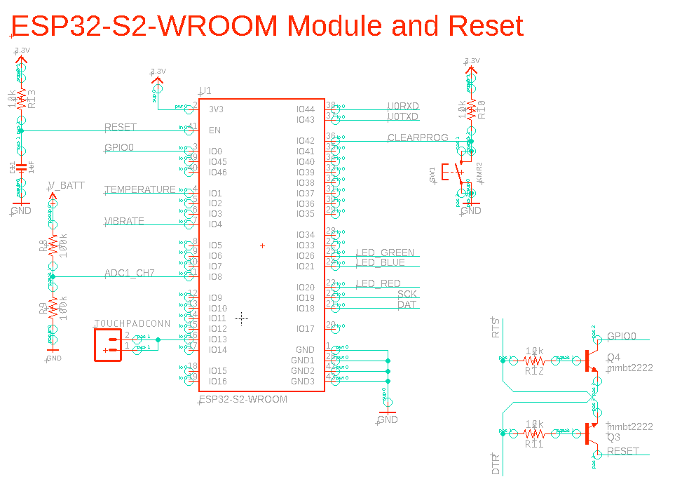

I have a problem that is stumping me... I have an ESP32S2 board which uses the ESP32S2 WROOM module.
After I put the ESP32S2 into deep sleep, on MOST boards (I've got one magic one that doesn't repro), after a while, the CPU will randomly reset. I've double checked the esp_reset_reason(), and it returns power on (as you can see from the dump below).
My assumptions were that there was either a power problem or something funky on the EN pin. I've put both of them on the scope and I never see ANY drop at all. They're both ROCK solid, even while the problem is reproducing over and over again, so I feel like it isn't that.
One interesting thing is that it seems to take a while the first sleep. It will sleep for 5-30 seconds the first time before resetting, but then after that it happens quite quickly. Sometimes it's immediate, looks like under a second, and sometimes it takes a couple seconds, but never nearly as long as the first time. That kind of makes me think of a charge building up on something, or a capacitor draining and never getting recharged... But for the life of me, I can't figure out what.
There are only a few pins on the ESP32S2-WROOM that are connected:
GPIO0 - Reset circuit
GPIO8 (ADC1_CH7) - Battery voltage divider
GPIO13 - Touch pad (for wakeup)
GPIO18 - Data line to HX711 ADC
GPIO19 - SCK line to HX711 ADC
GPIO20, 21, 26 - RGB lines to an RGB LED (common anode)
GPIO43 (U0TXD) - Serial converter
GPIO44 (U0RXD) - Serial converter
3.3V, GND
The rest of the pins are not connected.

Can you share the supply schematic?

Postby scottsh » Mon Jan 25, 2021 4:29 pm
Sure, no problem. Thanks for taking a look! :)
I've attached screen shots of both the power supply section and also the connections to the ESP32S2-WROOM module.
The correlation that I have noticed is that the lower the power gets, the more frequently it seems to hit this reset. When I have it sampling the touch pad every 15 ticks (~4ma), it seems to be pretty stable. Not perfect, but resets are rare. When I decrease the frequency of the sampling to every 90000 ticks (~110uA), it resets MUCH more often, on most boards. There are a FEW that seem to be petty stable no matter what, which I'm attributing to either part variance or ??
Once again, thanks for taking a look!
- Scott

Wow, great find!! Well that certainly made a difference! Yes, I think it's the same issue. I have the same concern as the person at the bottom of that thread, why is it signaling POWERON instead of brownout?
Now it seems to have a new weird behavior... The same code that was sleeping fine and waking up on a touch pad before (when the brownout was still enabled), is now sleeping just great the first time. However, once I touch the touchpad and wake it up, it wakes up great, DSLEEP, reason=touch wakeup, but it reinitializes the touch pad and tries to go back to sleep and just ends up in a VERY fast infinite loop waking up with touch wakeup constantly...
What's strange is that this same code worked fine (from the touchpad wakeup perspective) a minute ago...

FYI, circling back on this post.
It does appear that the cause of the reset from deep sleep is the brownout detector. The power supply lines look very clean on the scope, so not sure why the brownout detector is triggering, but disabling it does seem to fix the problem.
See details in this thread:
https://www.esp32.com/viewtopic.php?f=13&t=19208
