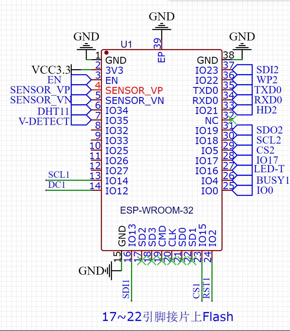

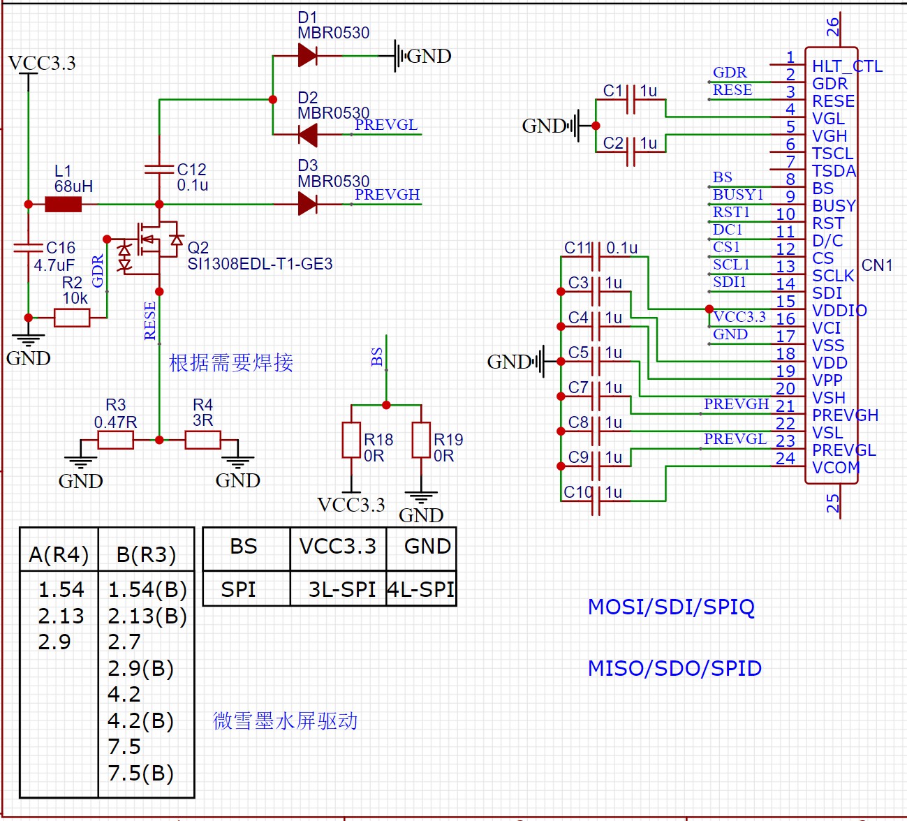

I have designed a 4.2-inch E-paper(ink screen) driver board, and the control is ESP-WROOM-32. There is no problem in blink example by IDF-included. When I modify the driver from the official of the screen , it is unable to refresh . Because this is the first time I use ESP32, I suspect that my SPI setting has a problem. Can someone help me :?:
The e-paper driver
[/img]
ESP32

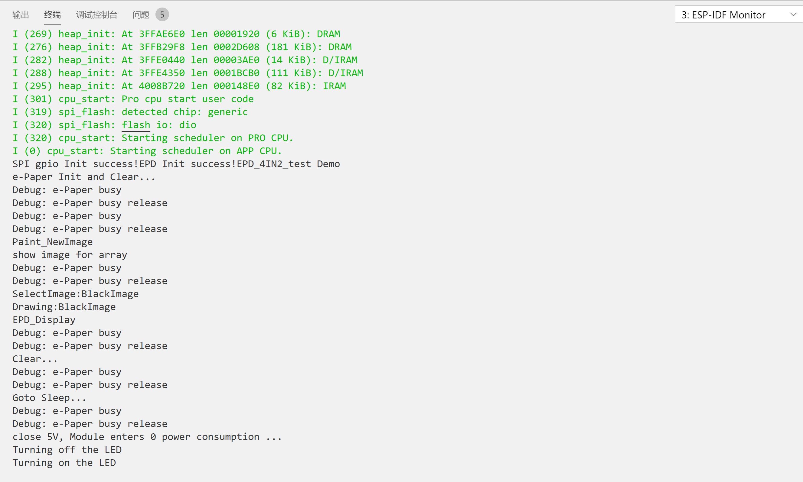

The monitor output

Postby ESP_Sprite » Wed Mar 31, 2021 3:38 am
Not sure if it matters, but in your GPIO initialization, you seem to have forgotten to also initialize CS as an output.
liankafohali
Joined: Sat Mar 27, 2021 2:24 am
Re: ESP32 SPI driver 4.2inc waveshare e-paper but can't refresh
Postby liankafohali » Wed Mar 31, 2021 8:07 am
thank you for you reply,this is my carelessness,my problem has been solved。 :D
