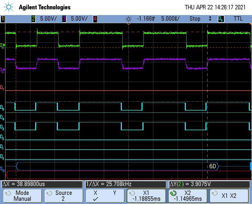

I'm using the UART with DMA by accessing the registers directly without using the driver from the sdk. Currently Im testing a RS485 communication at a baudrate of 230400. And there im getting 1 or 2 crc errors in a hour. On the oscilloscope it is all fine. No reason why the ESP32 should read something different. A screenshot is attached which shows the wrong byte. The ESP32 has read the byte 0x65 instead of 0x6D.
Analog Pin 2 is the RX pin on the ESP32. Analog Pin 3 the RS485 signal. Digital pin 3 is also the RX pin on the ESP32.

That is only happening with WLAN or with Bluetooth. With WLAN there are 1 or 2 errors in a hour and with Bluetooth every 1-2 minutes.
If both WLAN and Bluetooth is turned off, it is running several days without any errors.
Why? And can I prevent this errors, with Bluetooth and WLAN turned on?

You should provide hardware details, idf commit, and an example code to reproduce the problem. You have scope trace at the exact time of the error or scope logs crc errors? Is it always a single bit error?

Before I have tested in my own environment and disabled the parity and checked the data via CRC. There I see that there are always Single-Bit-Errors.
The Scope represents the Byte on the Bus which is correct (0x6D), but the ESP32 reads in this moment 0x65.
And it need to be some sort of hardware errors, because Im using an own UART driver with DMA access and the same problem is also occuring with the esp-idf UART driver.

Problem fixed. Bluetooth Modem Sleep was the problem. Zero errors in several days, when I disabled it.
