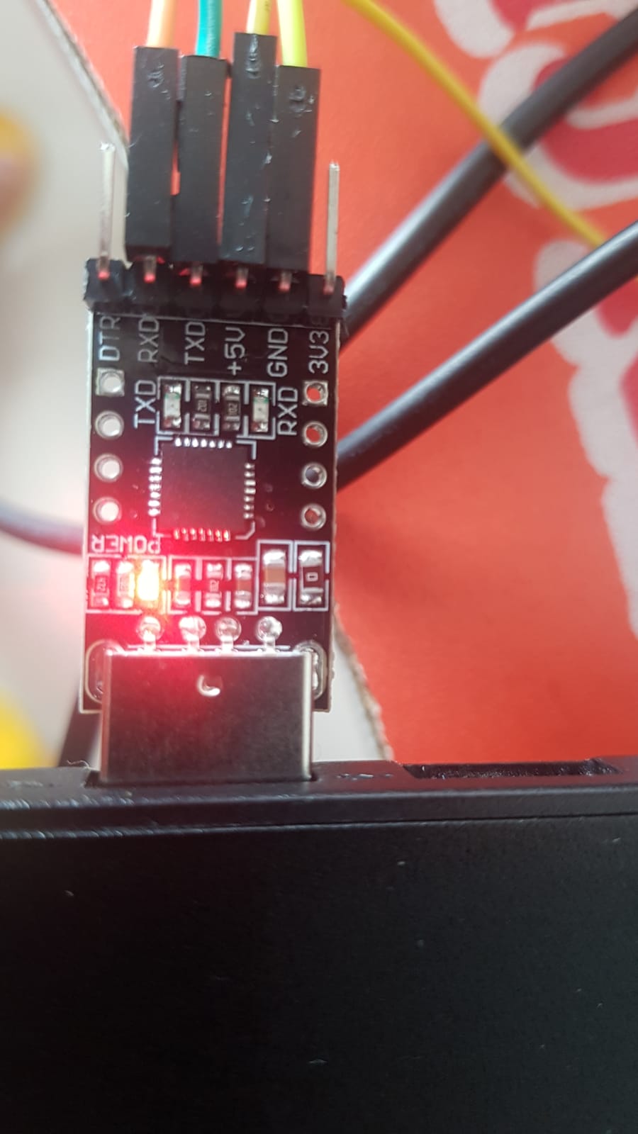

USB to TTL - CP2102 -Image as attached.

Which supply pin do you really connect? I see in the image is 5V? And do you know if power supply current is enough of this serial board? Could you see logs with UART0?

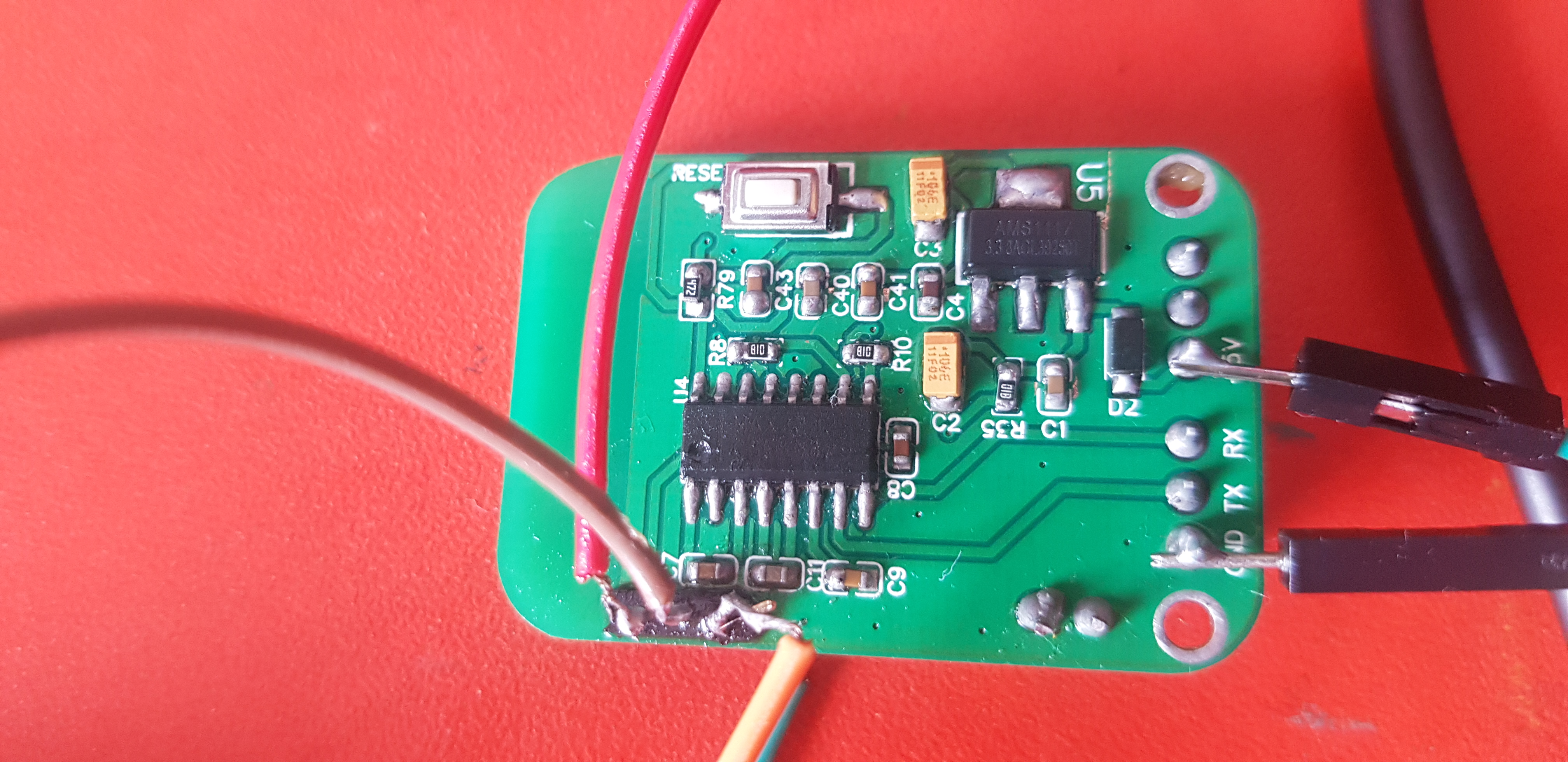

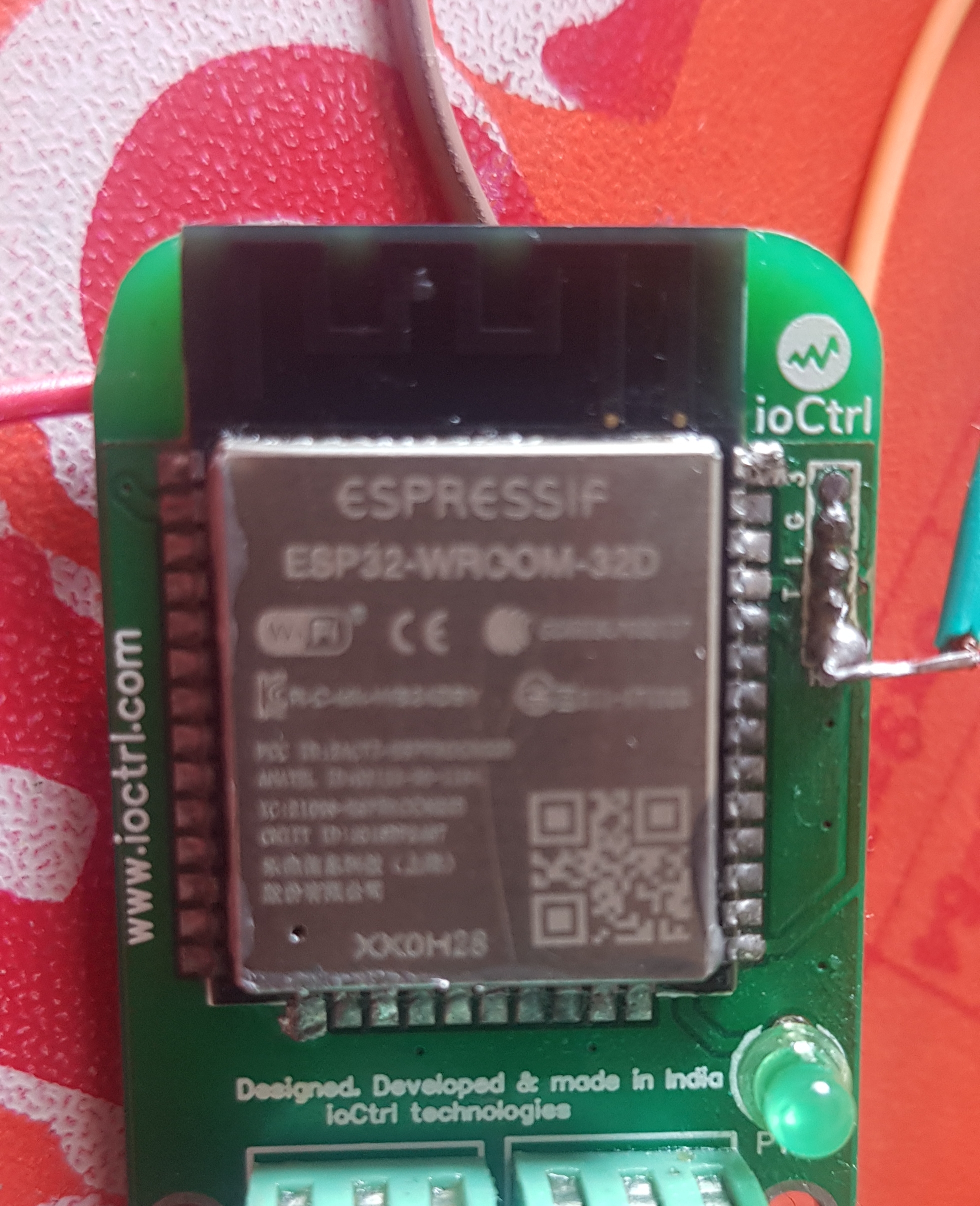

Here is the PCB prorotype board with ESP32 WROOM 32D module and will be use with Raspberey PI after this.
But somehow , i think we have received either corrupted flash or module. We have tried every possible way to correct it but noway to found the failure. Is there any other way to find the root cause of it?
Hereby attached is the PCB prototype board images for reference.
Thanks in advance for your support.

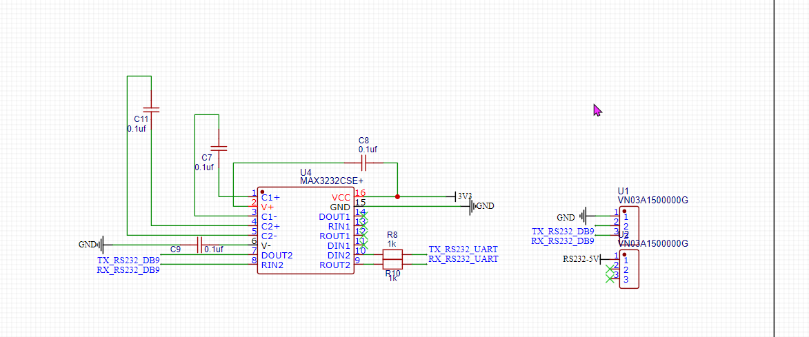

...U4 is not in your schematic? Can you send the *actual* schematic you're having issues with?

I do have issues in ESP32 schematics as U4 is just serial ic not linked with ESP32 module.
- Posts: 10
- Joined: Thu Oct 07, 2021 5:34 pm
Re: ESP32 breakout with ESP32 WROOM 32D module creates Flashing issues..
U4 is just serial chip and iam directly connecting 3.3v except 5 v. Weird behaviour like now sometime it start flashing and then stop at 44% and then fatal error no packet header. Then after that again continuousely showing fatal error.ESP_Sprite wrote: ↑Sat Oct 09, 2021 6:09 am...U4 is not in your schematic? Can you send the *actual* schematic you're having issues with?

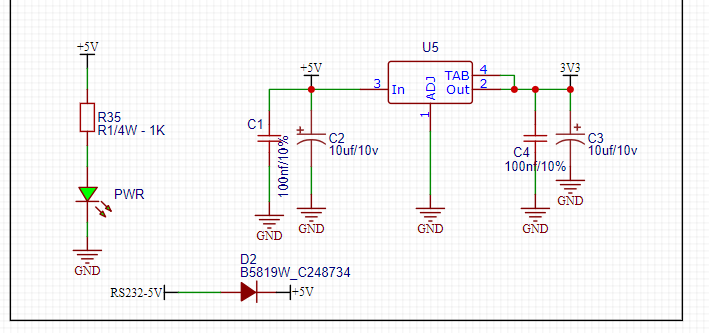

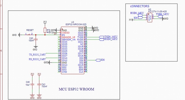

Below is the schematics attached. Power is 3.10v on all the required pins.
One more strange thing happened that when I applied 3.3v through USB TTL, then the AMS1117 3.3V regulator shows 2.5v on 5v input of the regulator.

Doe's schematics have an issue?,,, Chip has a flash issue,,,, or one more thing on the PCB board I used (3.3v,uart0, GPIO0, GND) on 1.27 mm dia holes. which should be at least 2.54mm.

Check your power supply. An AMS1117 is not supposed to output as low as 3.1V. You should see a healthy 3.3V (or very close to it) on all relevant pins.Below is the schematics attached. Power is 3.10v on all the required pins.
An LDO generally isn't specified wrt behaviour when you feed its input only, so this is kind-of expected. Also, don't use the 3.3V from your USB serial converter; it is not powerful enough. Did I mention to use a good supply already?One more strange thing happened that when I applied 3.3v through USB TTL, then the AMS1117 3.3V regulator shows 2.5v on 5v input of the regulator
Generally, get a power supply that you are absolutely 100% sure can provide 5V or 3.3V at at least 500mA. Feed that into either the AMS1117 in case of 5V, or directly into the ESP32 in case of 3.3V. Use wires that are thick enough. If there's an USB cable involved, make 100% sure it's good quality: you have no idea how many USB cables have shitty copper-plated aluminium wires inside.
