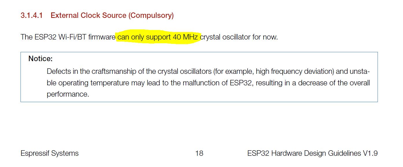

Postby hassan789 » Tue Jul 18, 2017 3:34 am
Per the hardware design guide, they are recommending a 40MHz crystal.
However, all the designs and dev boards I see use a 26MHz crystal. Can someone explain this?
Notes: I am using the D2WD chip.

I read that thread, it didn't really answer any questions. Unless I missed something. I know that the menuconfig has the option to support 26MHz too... is it better to use the 40MHz? I would rather use the 26MHz....

I think the design guidelines are outdated; I'll ask the documentation team if they can update them.
Edit: one of the things that does come to mind is that if you want to have low-power operations but WiFi/BT enabled, with 40MHz, you can run the CPU at crystal speed without needing the PLL. WiFi etc won't function at 26MHz, so with a crystal like that you're forced to use the next step up, which is 80MHz from the internal PLL. Not true, WiFi/BT need the 80MHz APB to be up.
More edit: We do have support for 26MHz crystals, but it's not used much yet, so there may be issues. Can I ask where you saw those ESP32 boards that use 26MHz crystals?

Postby Sprite » Mon Jul 24, 2017 3:18 am
