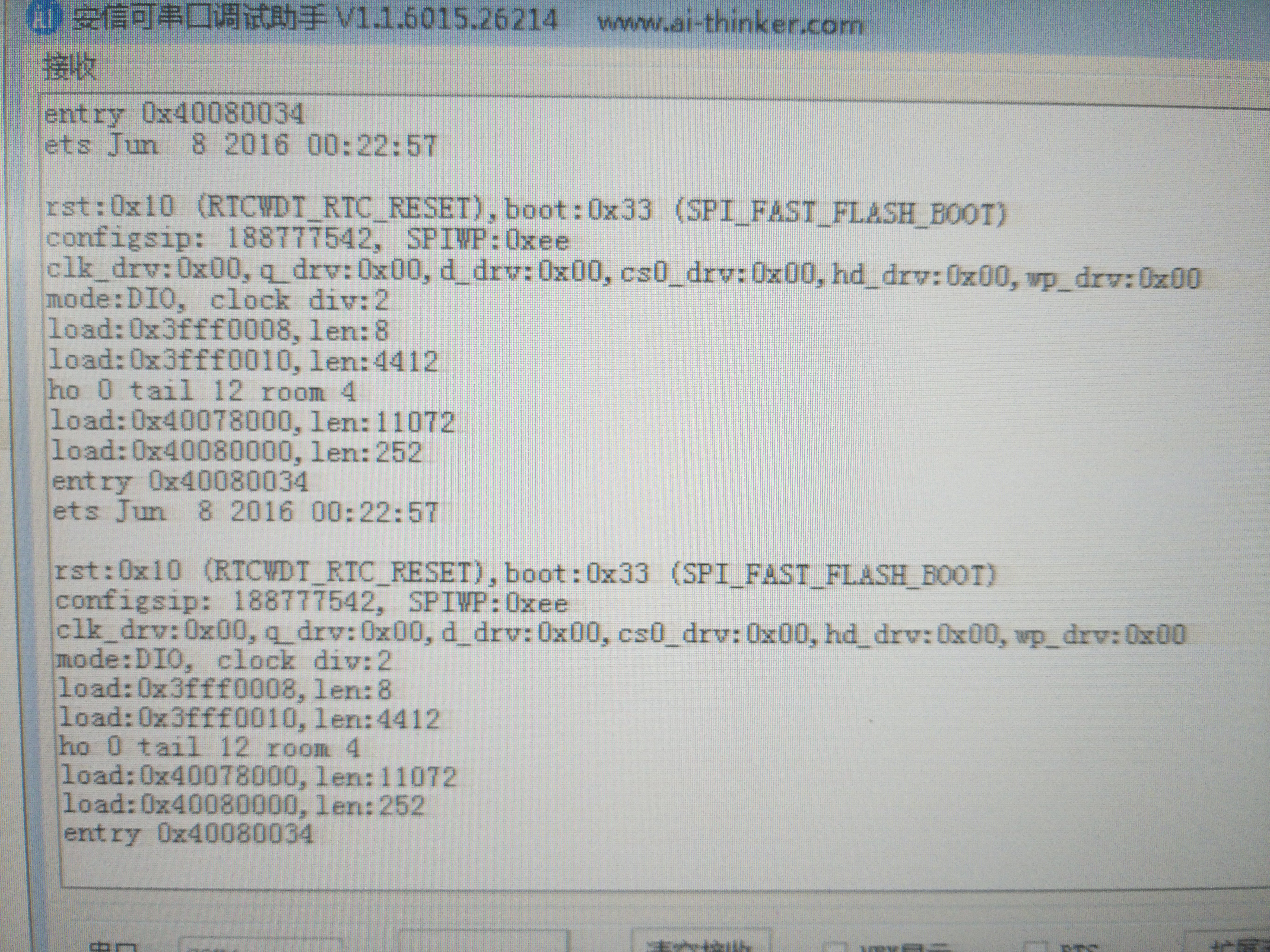

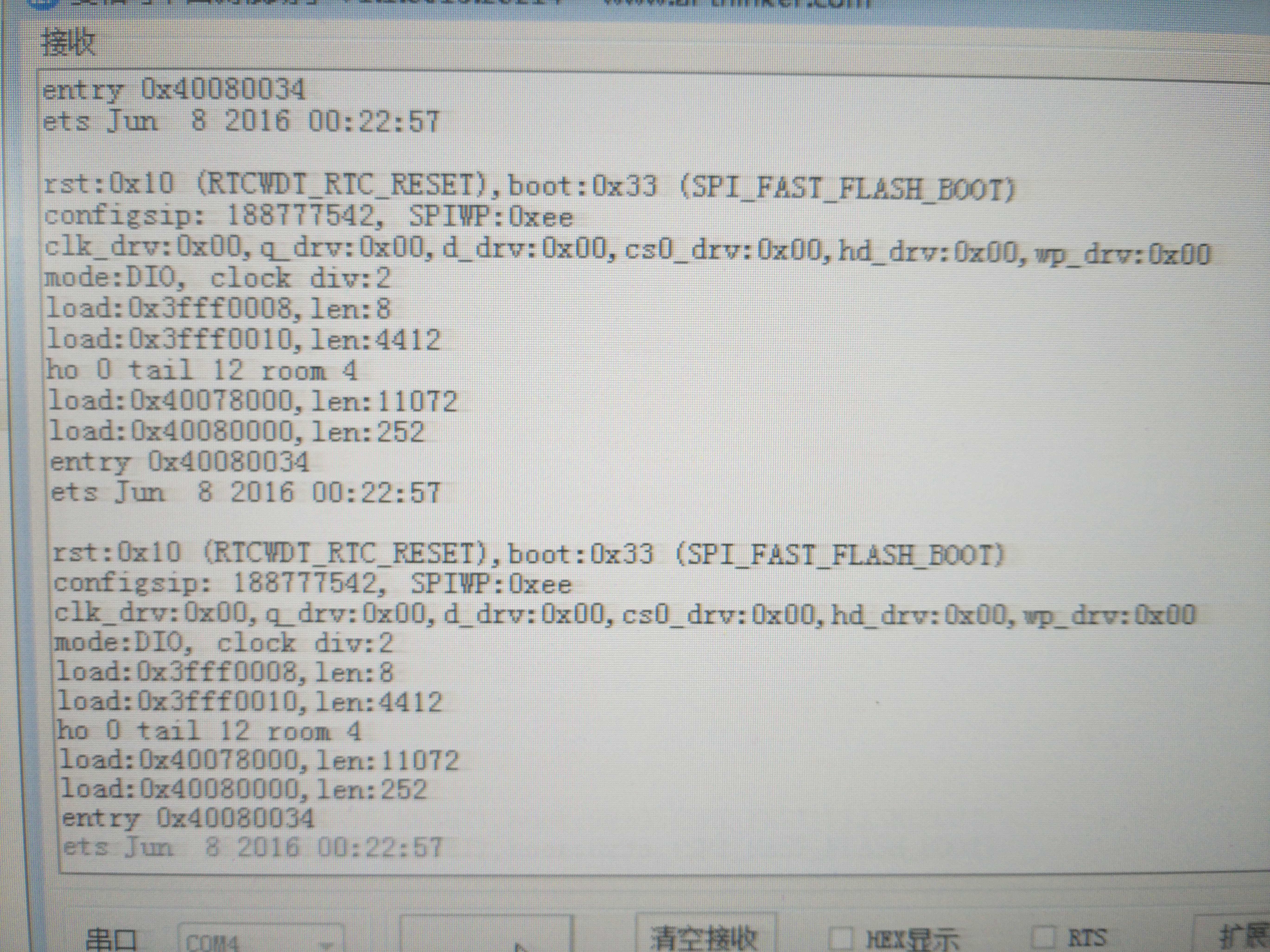

why the d2wd always reset auto for nothing?
Smartisan
Posts: 45
Joined: Sat May 20, 2017 3:08 am
Re: why the d2wd always reset auto for nothing?
Postby Smartisan » Fri Jul 21, 2017 1:56 am
Smartisan wrote:500ma@3.3V power supply are you sure? According to the post you think that the chip d2wd always reset is due to the power supply can provide enough current? But the hardware book don't say that the esp32 d2wd need so much power and current.Although it's peak current when it work for wifi.I doubt the if the esp32 d2wd @500ma can be said ultra low power chip ?
We met two chip are always reset reset and reset. If the d2wd chip is wrong or bug?

Postby rudi ;-) » Sat Jul 22, 2017 2:00 pm
Smartisan wrote:
Smartisan wrote:Do you have any other good suggestion for this issue? 500ma is so crazy that unbeleavable.
perhabs you forget onetime bootstrap pulled up for intern regulator 1.8V
then there is a rest risiko to damage the eMbeddedFlash

ESP_igrr
Posts: 2067
Postby ESP_igrr » Sat Jul 22, 2017 6:36 pm
No, the ROM boot log looks fine, and flash itself seems to be okay — 2nd stage bootloader is loaded into RAM; however it doesn't run further.
I recommend sending you firmware binaries to Espressif support for a test on a known good D2WD board, maybe there is a problem with your compiled binary (e.g. sdkconfig settings could be wrong).
WiFive
Posts: 3529
Postby WiFive » Sat Jul 22, 2017 7:19 pm
ESP_igrr wrote:No, the ROM boot log looks fine
Side question: what does SPIWP:0xee indicate since wp is not part of spi efuse config?
ESP_igrr
Posts: 2067
Postby ESP_igrr » Sat Jul 22, 2017 8:00 pm
There is no efuse space reserved for WP, so ROM bootloader reads it from the binary image header. 0xee means "don't configure WP". 2nd stage bootloader itself is loaded in DIO mode, and then it enables QIO.
