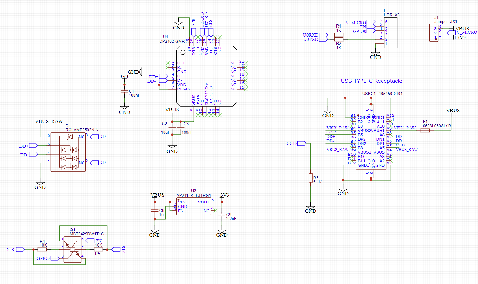

Hi all,
I've designed a very simple board using the esp32-pico-v3 and an external flasher using a CP2102.
when I try to flash anything, I get this error:
esptool.py v3.3
Serial port COM6
Connecting.....................................An error occurred while uploading the sketch
A fatal error occurred: Failed to connect to ESP32: No serial data received.
For troubleshooting steps visit: https://docs.espressif.com/projects/esptool/en/latest/troubleshooting.html
Arduino IDE 1.8.16, Windows 11, driver version 11.1.0.53, board selected esp32 pico-d4 115200
You can find the schematics attached. I added external 100nF caps on GPIO0 and EN to GND, and an add 10uF cap on EN. The result is still the same if I reset manually the circuit using 2 buttons.
I bought a cp2102 adapter and I still have the same problem.
Thanks in advance

You swapped U0TXD and U0RXD twice, meaning the Rx of your serial-USB chip is connected to the Rx of the ESP32.

Are you missing a pullup on EN?
Also you need separate 5.1k resistors for each USB CC pin. Raspberry Pi had well-publicised problems sharing the resistor like that.

ESP_Sprite wrote:
Thu May 26, 2022 3:05 am
Hi, thanks for the reply.
Are you sure about it? They seem ok to me.
I swapped them in the SCH so that I don't have to remember it every time. (I anyway tried to swap them IRL just to double check)
ESP_Sprite
Posts: 9020
Re: ESP32-PICO-V3 won't go in download mode
Postby ESP_Sprite » Fri May 27, 2022 1:08 am
jacopo99 wrote:
Thu May 26, 2022 10:06 pm
Yes. U0RXD of the ESP32 goes to pin 2 of the header. On the other side, pin 2 of the header is called U0TXD (swap 1), but then that line runs to U0RXD of the CP2102 (swap 2)

boarchuz wrote:
Thu May 26, 2022 4:14 am
Hi, thanks for pointing that out.
Yes, I already changed it for the next rev of the PCB. I checked the voltages on the uart bridge and both vbus and 3.3v are ok, so I should be ok. I managed to write to the CP2102 EEPROM using their Silabs utility, so the link should be fine.
Externally I a pull-up both from gpio0 and EN to 3v3. Then I tried without one on GPI0 but still nothing, And then I tried without any, but still nothing. Multimeter shows that voltage drops to 0 and goes back to 3v3 correctly using the push-buttons.

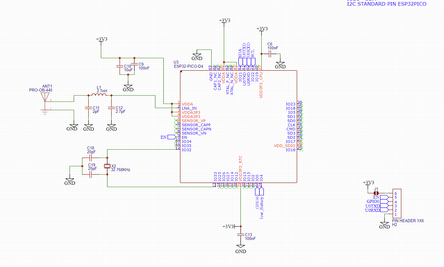

Ok,
I revisioned the schematic and added all the necessary fixes. There's also the EN 10uF cap and pullup res onboard now.
I'll route the PCB and see if it works this time around, but the error was anyway quite odd. II suspect it might be on the esp32 side.

ESP_Sprite
Posts: 9020
Postby ESP_Sprite » Mon Oct 03, 2022 2:50 am
Looks like your ESP32 is not booted up. What's the level on EN? 3.3V still stable?
EDIT: Perhaps I'm missing it, but is EN pulled up anywhere now? I still don't see it in the schematic.
