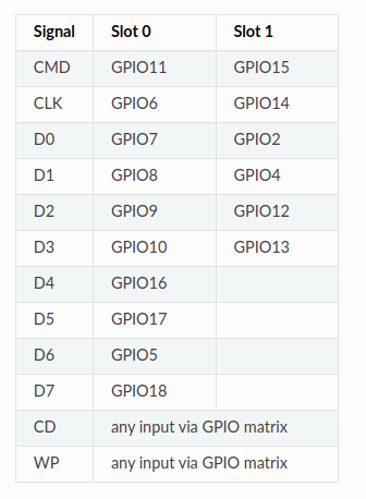

https://docs.espressif.com/projects/esp ... l#overview
In old esp32 SDMMC driver in 1-bit mode allows to assign any pins with IOMUX, n-bit mode (slot 0) does not allow that (hardware limitation):
Screenshot from 2022-07-28 00-34-56.png (33.23 KiB) Viewed 4159 times

Well yes I am using Slot 1 and on this version of ESP32 I have to use the one listed on the table, which I do.
I did some tests today using a switch on GPIO12, so that it is floating at boot, then I connect it to D2 of the SD Card, and this produced no change at all: still not working in 4 bits mode on Slot 1 for the 32 GB card.
Any clue anyone?
