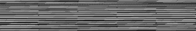

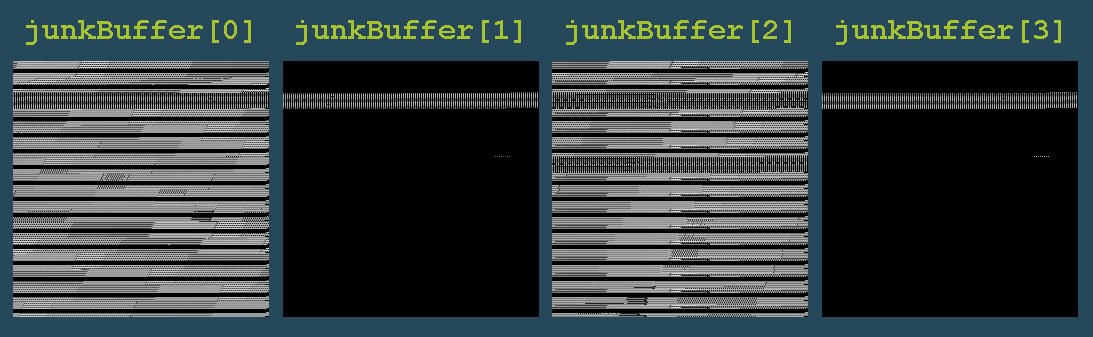

(2) I ran 4 different scenarios and picked up every N-th byte (0...3) from the junkBuffer and got the following images:
Once (on a very rare occasion) I happened to get a more or less structured pattern:

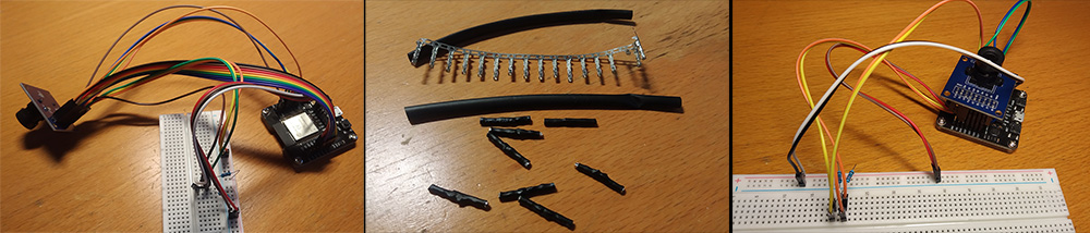

(3) The picures above were generated by the camera with a terrible 20cm wiring. In hope to cut off the possible noise I reassembled the design replacing signal wires with a thick short soldered pins wrapped in isolator. VCC/GND/SDA/SCL/RESET and PWDN are left untouched.
Such a modification did not yield any positive result however :(

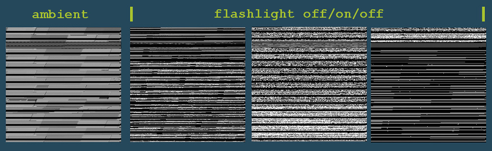

(4) LIGHT sensitivity
With grayscale test mode turned off the camera senses the amount of light and outputs lighter or darker images. The image on the left was made in the ambient light. After I hit a sensor with a direct LED-flashlight the camera gave significantly lighter images.

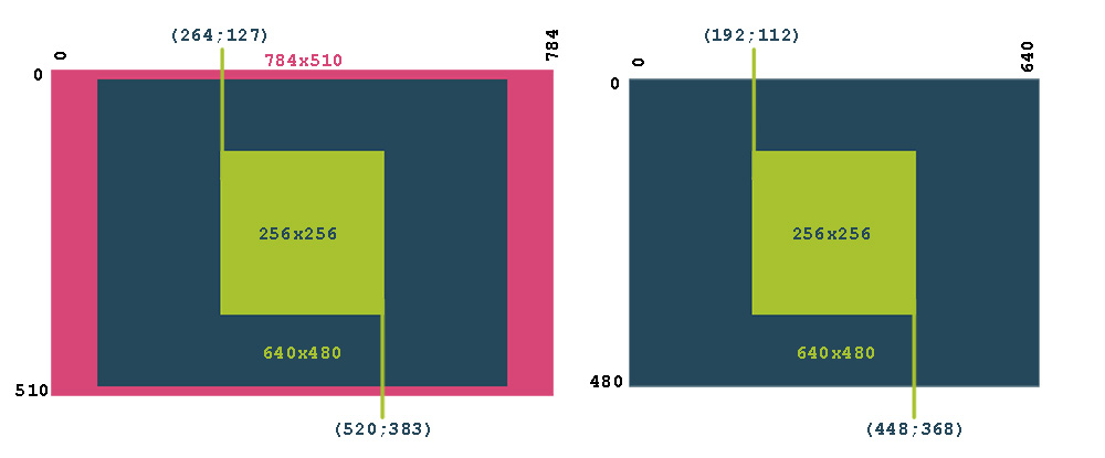

(5) WINDOWING
Datasheet says the actual signalling area is 784x510 pseudopixels whereas the active area is limited to 640x480.
So I tried setting up 256x256 window using both methods:
With no luck.
Finally, I turned windowing off and tried to fill the incoming array of pixels as 640x113 image. Again, garbage only.

code4sex

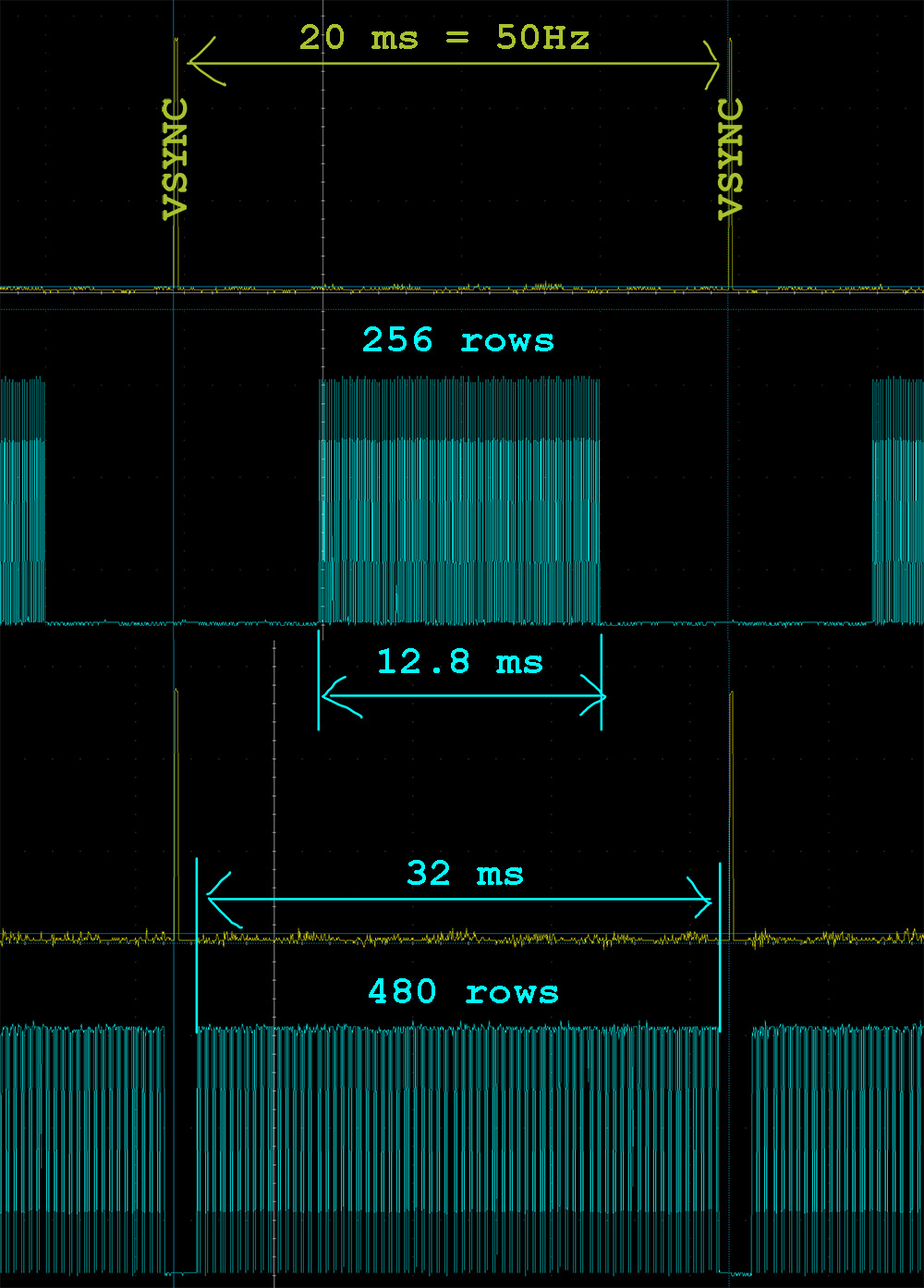

PS. A short notice on h/w - here are some snapshots from the scope.
Windowing ON/OFF comparision:
Those are two screenshots merged in one and matched against VSYNC mark: yellow signal = VSYNC, cyan signal = HSYNC (HREF)
One may see the windowing work as expected. Also, VSYNC is low when HSYNC/HREF is high, so appropriate signal inversion is made other esp32 side:
gpio_matrix_in(config->pin_vsync, I2S0I_V_SYNC_IDX, 1); // 1 = INVERT SIGNAL

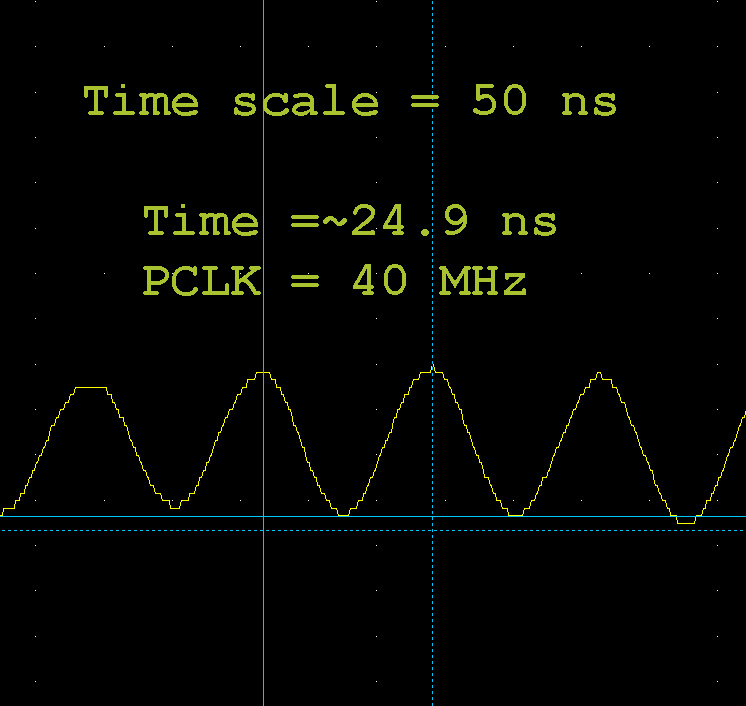

PCLK line:
So the h/w is operating alright if that might matter anyone....
inverse2k1
Joined: Wed Dec 06, 2023 12:52 pm
Re: ESP32 + OV7670 camera: need assistance
Postby inverse2k1 » Wed Dec 06, 2023 12:58 pm
hi,
two observations:
your line impedance might still be completely mismatched.
But, by the looks of it, the camera configuration registers seem to be completely off track.
It's like the pixel format and maybe the frame format are different from what you expect.
Also, knowing the device does not encode in jpeg format, the frame buffer configuration might be wrong as well.
