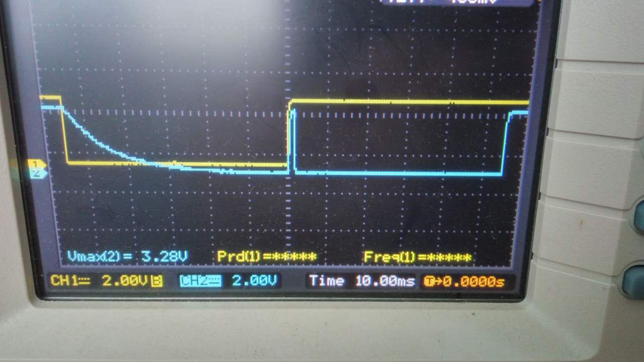

I have other question: Please see the attachment.
Blue - IO0
Yellow - EN. Why IO0's wave like this? It looks like that there is a big capacitor on IO0. But from schematic, there is no capacitor. I feel that It refers to the error

What hardware did you take this capture from? If it's the board in your first post, can you please post the schematic?
It's same with ESP32-DevKitC of Espressif.

The V1 (blue PCB) DevKitC boards have a bug with the auto-reset circuit where it doesn't work reliably. You need to hold down the "Boot" button (J3, pulls down IO0) in order to reliably enter the bootloader. V2 (black PCB, "ESP32_Core_Board_V2" marked on bottom) DevKitC does not have this problem.
