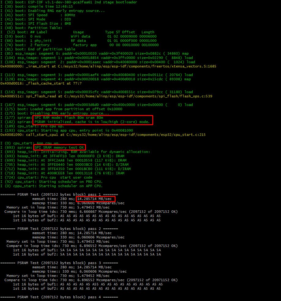

Postby hgptamn » Wed Feb 14, 2018 11:45 am
To all newbies out there (me included) testing pSRAM compatibility with their boards, here's what I did to get it working.
First of all make sure you're on the latest ESP-IDF verison. I'm on ESP-IDF v3.1-dev-380-gca3faa61 2nd stage bootloader as of testing this.

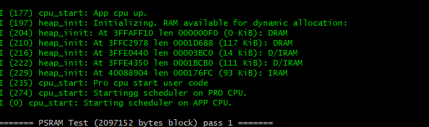

Second of all do you see SPI SRAM (sPRAM) tests being done during the startup sequence of the ESP32 like in the image bellow?
If yes, then the problem might be within your code.
If no, it means that your start-up sequence output looks something like in the image bellow, with the SPI SRAM checks missing.
If so, what I did to fix the problem was simply to go in the sdkconfig file in the root directory of your project, look for:
CONFIG_SPIRAM_SUPPORT=
and set it to:
CONFIG_SPIRAM_SUPPORT=y
For some reason, on my setup this feature was missing from make menuconfig. It only appeared after I've manually modified the sdkconfig file. Once configured in the sdkconfig file you should be able to see SPI RAM config options under make menuconfig ---> Component config ---> ESP32-specific ----> Support for external, SPI-connected RAM -----> SPI RAM config
The code that I've been using for testing the sPRAM can be found bellow under spram.rar
Fortunately it is stable at 80MHz flash and sPRAM :D

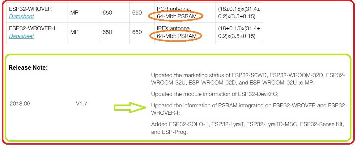

Posts: 1759
Re: ESP32 PSRAM support
Postby rudi ;-) » Thu Jun 21, 2018 11:21 am
Hopefully, 8 MB psRAM will be supported in esp-idf ...
btw: did you note the update on modul [ordering info v1.7 from 2018.June]?
i think it is in the pipe and the HW is ready for MP ordering
ESP32-WROVER 64-Mbit PSRAM*
ESP32-WROVER-I 64-Mbit PSRAM*
espressif_products_ordering_information_en_June2018.pdf
updated ordering info JUNE 2018
Wrover 64MBIT PSRAM ( Side 2 )
(395.2 KiB) Downloaded 958 times

They probably aren't manufacturing the 32mbit for whatever optimization reasons. But it will be a bit difficult to use all 64mbit since it would be 32mbit per CPU unshared so any task using spiram would have to be pinned to the appropriate core and not share memory with tasks on the other core. The extra 32mbit could also be used as a data stash I guess.
