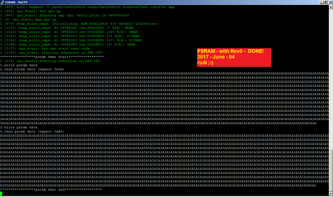

ESP32 rev0 pSRAM - done!
@John Lee
sry - but i could not wait - now i have it manage by self.
we have events on june 6. and we want show on the education board the pSRAM
we are ready on one weekend - how long pycom have played? 1/2 year? 8-)
done on one weekend!
now its time to go few hours sleeping.

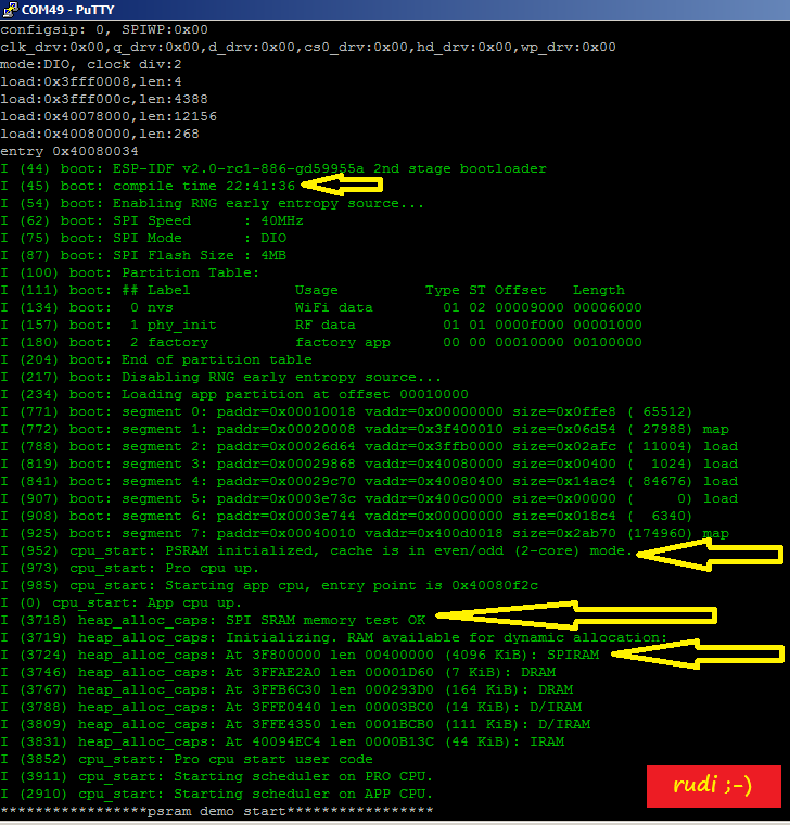

now playing with the modes
SPI PSRAM check on boot -> ok
we have now 4096 KiB in ESP32 rev0 available :mrgreen:
now we go on to work with it.

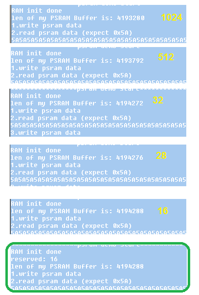

can you perhabs say, where the 16 byte are reserved,
i search just in time -
just one word:
i am happy now with this what here works and how it works -
now i try to combine it step by step with the application code
will see/test where and how the limits then are in rev0 / rev1
So how to trigger the bug on rev0?
what was done:
toolchain like jeroen described
one step more after check out future/psram_malloc, update libs
the boot check on 4096 was ok.
the demo/compare code was ok
the 1 MB MallocCaps works
the 2 MB MallocCaps works
the 3 MB MallocCaps works
on 4 MB MallocCaps i work just in time -
i look how much is reserved for something,
in menuconfig there are some parameter
i was gone simple steps,
final i found out, there are 16 Byte reserved - or i do a mistake with my code:
   uint8_t res = 16;
    // uint32_t
	char* buffer = pvPortMallocCaps((4*1024*1024)-res, MALLOC_CAP_SPIRAM);
        if (buffer==NULL) {
           printf("could not create SPIRAM Pointer\n");
        } else {
          printf("RAM init done\n");
          printf("reserved: %d\n", res);
          memset(buffer, 0x67, ((4*1024*1024)-res));
          buffer[((4*1024*1024)-res)-1] = '\0';
          printf("len of my PSRAM Buffer is: %u\n", (uint32_t)( (strlen (buffer) + 1) * sizeof(char)));
        free(buffer);
for better see 4*1024*1024
i wrote not
memset(buffer, 0x67, (4194304 -res));

The heap allocator needs a few bytes for internal housekeeping, yes.

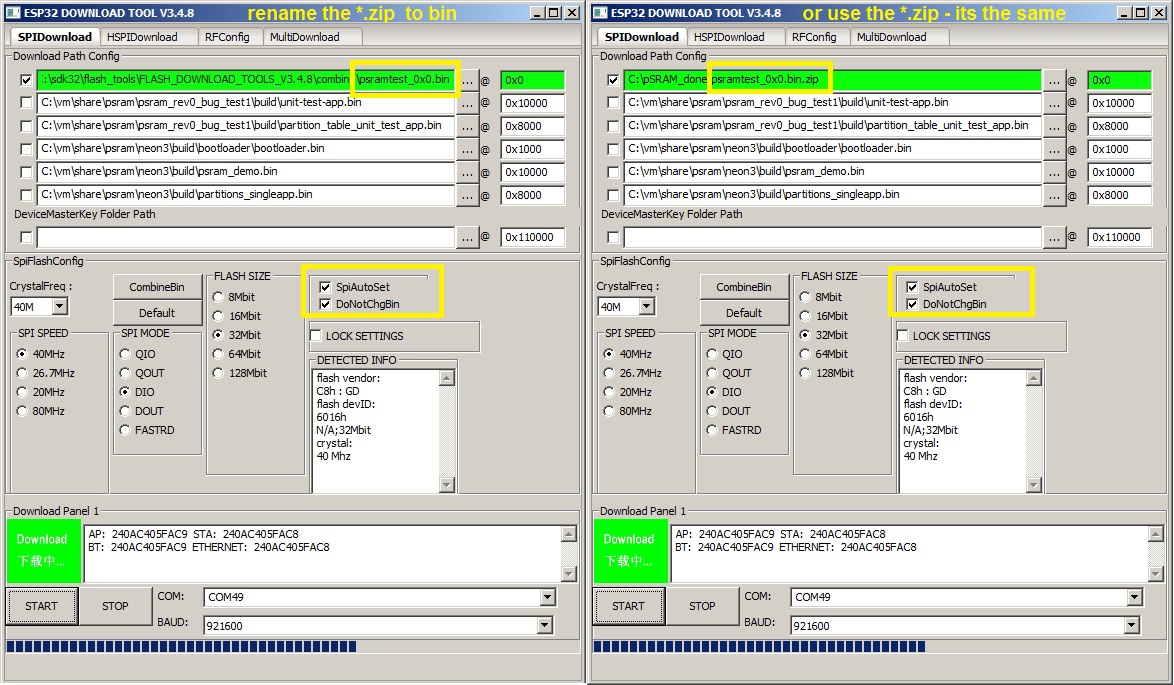

here is a small unofficial check file as firmware.bin to check
if you can't build toolchain/compile the firmware.
- revision
- embeddedFlash/extern Flash
- pSRAM / no pSRAM
- if pSRAM
psramtest_0x0.bin.zip
(426.78 KiB) Downloaded 1234 times
rename the *.zip file to *.bin file and flash this to 0x0
example flash tool windows V 3.4.8

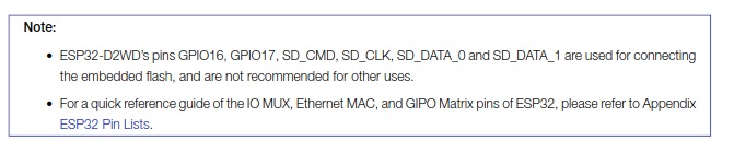

now ESP32-D2WD
first,
in the actually ESP32 Datasheet ( side 17 ) we read:
esp32_datasheet_en_2017_june_9_V.1.5.pdf
Datasheet
V 1.5 2017 June 9
(1.12 MiB) Downloaded 925 times
can this be right?

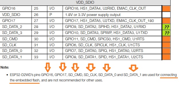

why i ask:
in the datasheet stand too:
there is named, that GPIO16, GPIO17 is used for the eMbeddedFlash
there comes now confused question/thinking:
With regards to using D2WD with PSRAM: it is possible, as the extra CS and CLK signals to PSRAM are routed via the GPIO matrix. But depending on the pins chosen, it may not be possible to achieve 80MHz clock due to timing differences between various pads. 40MHz clock should still be possible.
- this two pins comes from the GPIO Pad and can not so fast (40) / ( 80 )
- the SD_DATA2 and SD_DATA3 are in VDD_SDIO ( VSDIO ) Domain and can fast but not used?
are the pins "named" swapped perhabs?
if not, in which mode is the eMbeddedFlash then run, there is only 2 DATA Pins, it looks then like not quad mode?
how we connect the external SRAM to the ESP32-D2WD in this steps of pin notes?
we have then no CLK and CS for external SRAM from the VDD_SDIO ( 1.8 )
can it be, cause the note talk from GPIO16 and GPIO17, ( GPIO PAD PINS ) ,
that we drive the eMbeddedFlash and the external SRAM with the same (slower ) CLK
( btw which pin is used? - there is given SD_CLK from VDD_SDIO domain )
and use we GPIO20 ( was in the VDD_SDIO domain ) then as CS for the external SRAM ?
short:
in which mode we connect which pins to external SRAM on ESP32-D2WD ?
EMAC_CLK_OUT ( GPIO16 ) then is not more existent in ESP32-D2WD, cause is used for the eMbeddedFlash, right?
( is this then on other pin or completly not more possible? )
thank you.

Sorry for the short reply, but to be honest we haven't really looked t the D2WD/PSRAM combo that much yet... We will do this in the future, including determining which pins to use.
