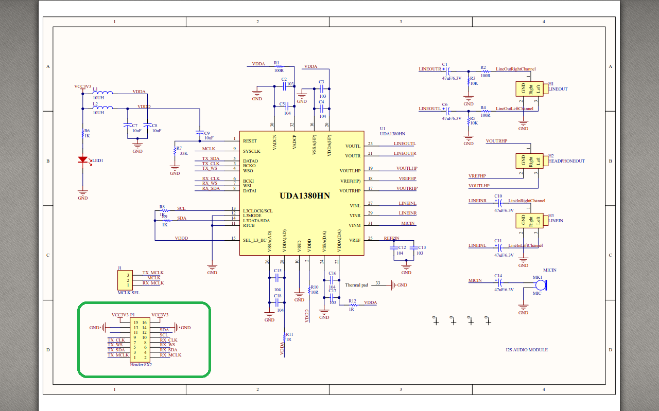

so this config must be valid for run for the ICS.I2S as Left Channel example?
and for Left and Right ( 2 Mics ) example too?
perhabs you can look small time on this picture, please:
The ICS-43434 works similar to the SPH0645LM4H, so this looks good to me. You will have to clear the bits 25-32 and 58-64 because they're left floating instead of zero-padded, but I think thats it.

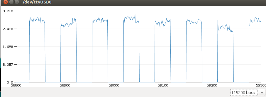

thanks a lot @andriy .... so it seems i am getting some feedback now, but its still going between periods with data and periods without data ... using serial plotter i can see this:
any idea what could be causing that ?

Actually I don't think the bit shift is correct. I have since switched to a more efficient version that does block transfers, and avoids endianness issues by working only on bytes. The signal will be more silent, but I think that is because the mic is quite sensitive and now reflects its fully dynamic range (truncated from 18 to 16 bit).
Here is an example that converts from 32 bit single-channel stereo mic input to dual-channel 16 bit output. You can leave out the conversion if both I2S interfaces have identical parameters.

@buddy
what you think
can we take for a short test UDA1380 too ?
it has Tx and Rx and I²C for Vol and others.
Sheet SRC
