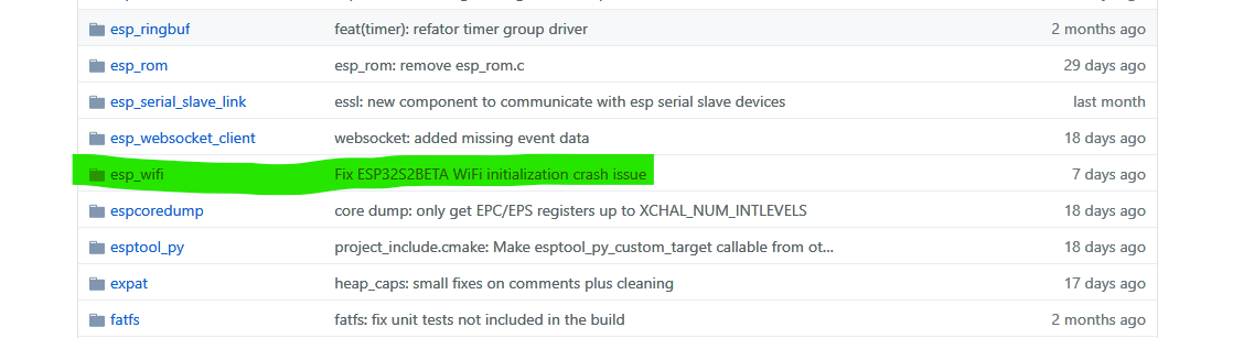

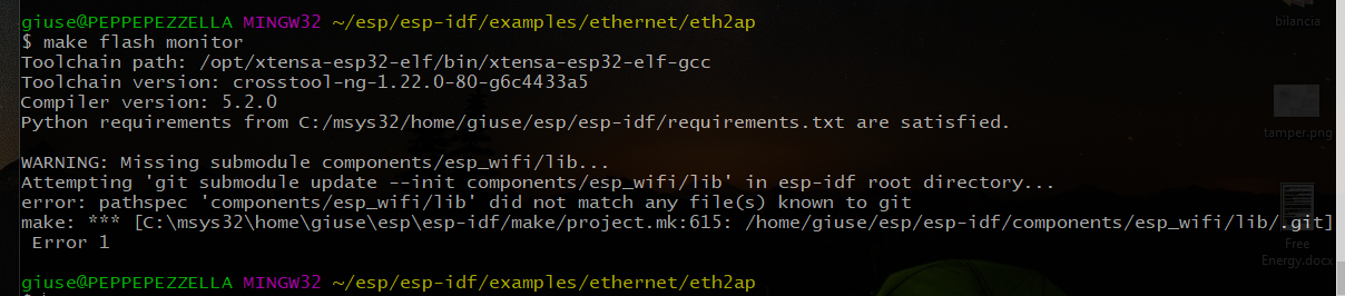

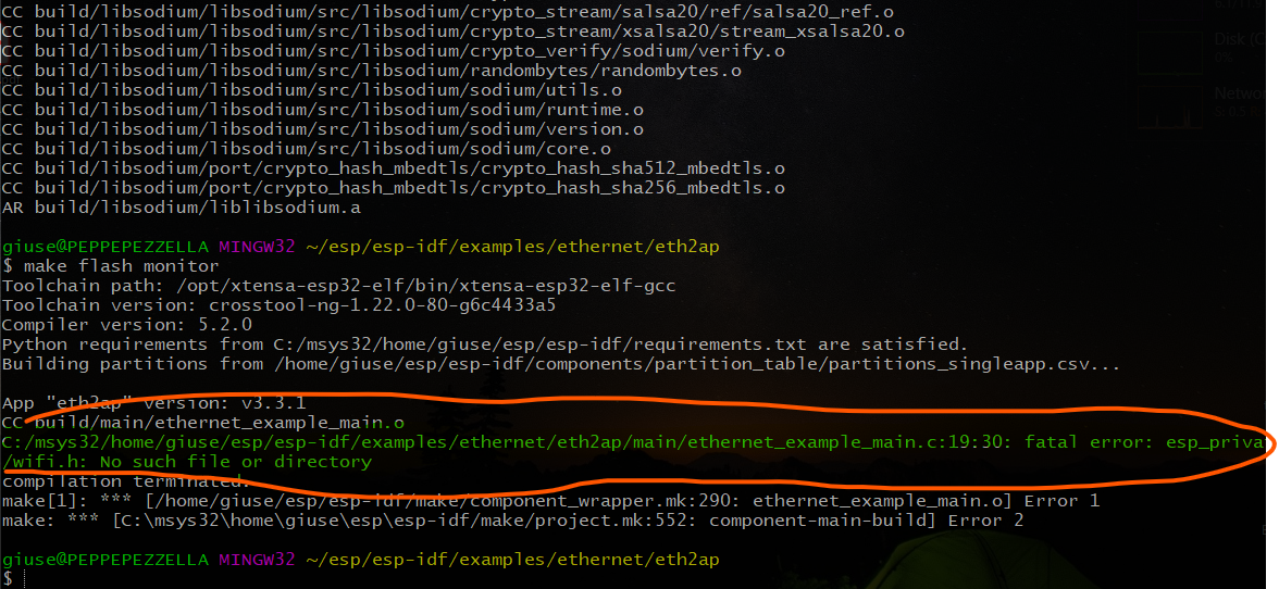

I have just clone v3.3.1 and try to flash eth2ap examples but I have this error:
fatal error: esp_private/wifi.h: No such file or directory
compilation terminated.
Now if you look in repository this directory exist but under msys32/components no How it is possible??
Thanks

you missing esp_private/wifi.h cause eth2ap is an example from this up esp-idf 4.0-beta1
and also esp_private compo is from up esp-idf 4.0-beta1 and in down esp-idf V3.3.1 not existend.

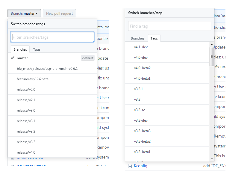

Hi
you can git the actually esp-idf version
and checkout the need version / tag
have a look to the github
you can select branches also tags.
how you git the repo in your way?
do you use command line or do you use a GUI git ?
rudi
