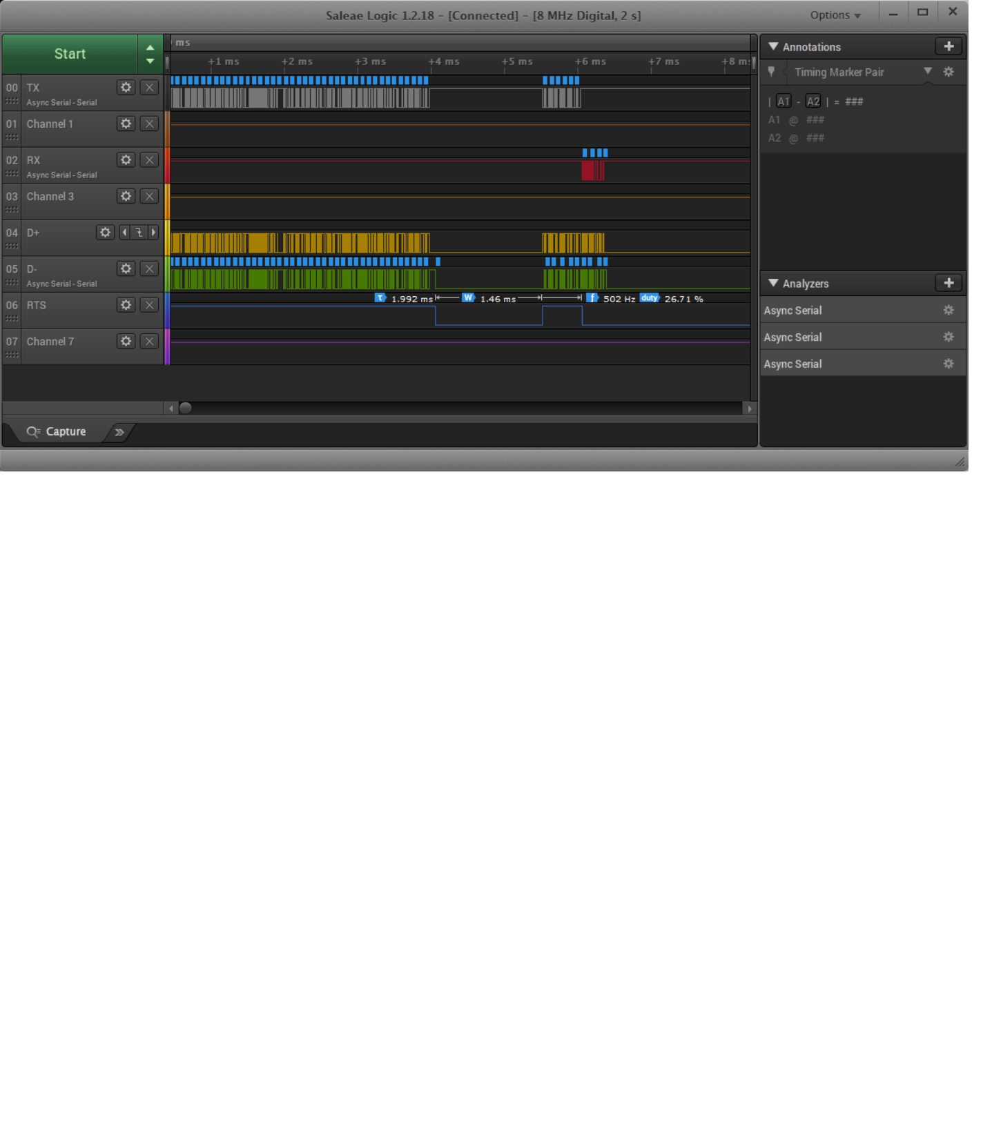

I have set up a UART on ESP32 that sends RS485 data every few hundred ms.
After a long time (it might be several hours or a couple of days), the ENABLE pin stops working correctly and I loose connection to remote devices on the RS485 bus, it does not recover until I reset the power supply. At first I thought it was a hardware issue but when I looked on a scope the ENABLE pin was set high for entire duration of data packet ok for long time but when it plays up the enable goes high for a short period of time before the data packet and goes low before data is sent.
Is there any known issue with the UART driver software that could cause this? Should I disable the enable function and manually toggle the enable using GPIO during transmission instead?
My config is below.

Re: RS485 Enable pin issue
Thanks,
That is the exact error I have and same signals on scope.
I am a bit confused about the solution. There is a suggestion to add this line below. Is this added in my code somewhere or does the actual uart library component need it added (I am using ESP-IDF 4.3, if this needs editing does it mean no fix was implemented in the component)?
"uart_clear_intr_status(uart_num, UART_TX_DONE_INT_CLR_M);"
Where should this line be placed and is it all that is required to fix the issue? The post does not seem to have a resolution accepted.
@orbitcoms,
Do you use the `uart_wait_tx_done()` function in your code to wait for completion of transmission?
@sramberg2, @orbitcoms,
Thank you for answers. I am asking about using of uart_write_bytes() because this function has side effects when RS485 HF mode is used. It may disable the TX_DONE interrupt after timeout and interrupt will never come. You can avoid using of wait_tx_done() for now in your code.
During my investigation some time ago it was not possible to reproduce the issue you are mentioned but it was possible to reproduce other issue when during active transmission the TX_DONE interrupt come and disables RTS line (this one was fixed in the driver, see the picture attached echo_test1.png).
So, in order to solve the issue I would propose to do steps below:
1. Try to place default UART interrupt handler into IRAM to avoid possible latency of interrupt activation (when access to nvs or flash). Set CONFIG_UART_ISR_IN_IRAM = y for this.
2. The patch attached can be used to check approach from github issue #4178.
3. Compile your application and start to check issue with the RTS line.
I need your help to check this approach because it takes time to reproduce. I will continue with the investigation of the issue.
Please follow the suggetions above and keep me posted about results.
Thanks.

- RTS line deassertion issue when transmission is in progress
- echo_test1.png (198.29 KiB) Viewed 9127 times
