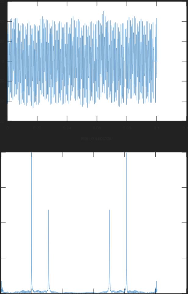

Postby millroad » Sat Feb 25, 2023 7:51 pm
I'm using an INMP441 i2s microphone (datasheet) and using the esp-dsp library and esp-idf 5.0.1 to create an fft series. I'm sampling at 10 240 Hz but I can't see any signals higher than about 2500 Hz, and the plot of the fft shows an alias around 2500 Hz as well. Is there some error in my i2s setup? Is using the microphone as mono making the sample rate half as big? The word select clock is supposed to be the same as the sample rate for non-PDM mode.
I played a tone of 2000 Hz and dumped the data to serial, then ran an fft in matlab. The mirroring around fs/2 is expected but not four lines, and anything above 2500 Hz disappears..

I figured out the issue, when setting the sampling bit width to I2S_DATA_BIT_WIDTH_16BIT esp-idf sets the word length to 16 bits as well, so a whole frame is just 32 bits, the i2s bckl was only 327 680 hz. I was expecting 64 bit clock cycles per frame, which would make the bckl 655360 hz. Just setting the .slot_cfg.ws_width = 32 didn't make a difference so I ended up sampling 32 bits of data instead, and throwing half of it away.
The INMP441 microphone requires 64 clock cycles per frame, is there any way of making esp-idf sampling just the first 16 bits of the left channel? What should the configuration be?
I don't think the documentation is very clear that the frame length is dependent on the data bit width. Analog devices writes in their guide on i2s:
The data word length is often 16, 24, or 32 bits. For word lengths less than 32 bits, the frame length is often still 64 bits and the unused bits are just driven low by the transmitting IC.
It seems resonable that the word length is mentioned somewhere, and how the data bit width affects it.
