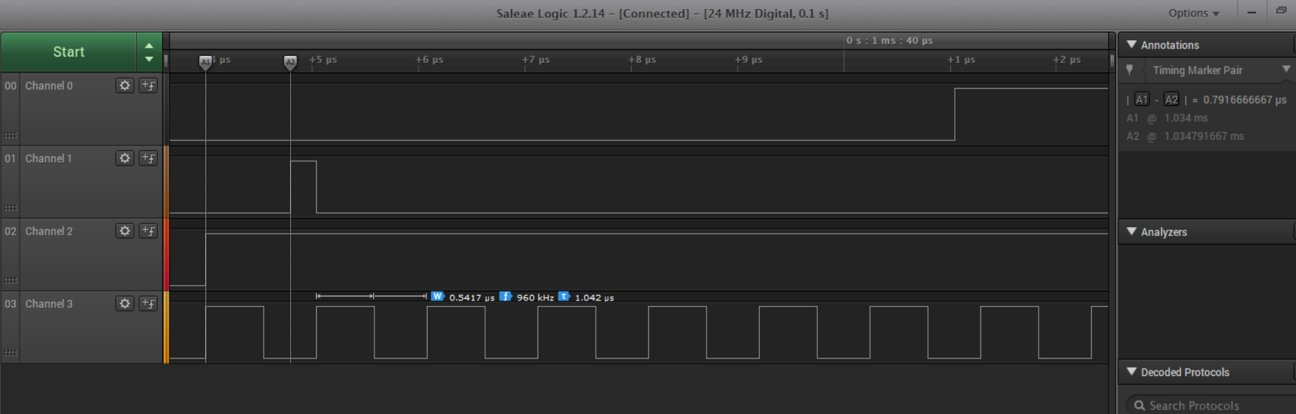

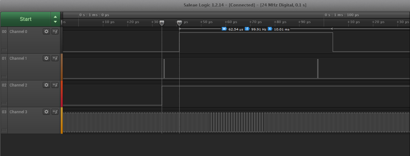

The lcd interface signals are a 4bit data bus (4 horizontal 1-bit pixels are transmitted for every clock), uninterrupted clock , hsync (this is just a pulse to latch a line of pixels), a FR signal that toggles every frame, and a one line wide vsync pulse per frame. Have attached a grab of the signals ( chan0=VS, chan1=HS, chan2=FR, chan3=CLK )

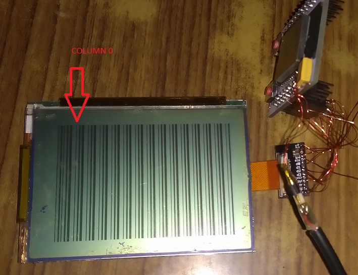

I have a stable image on the LCD, and the pixel left-to-right ordering corresponds to the byte ordering in the frame buffer. ESP_Sprite, thanks for the help !
Just have a problem with the line synchronization. col 0 of the image is offset to the right in the LCD. In my grab of the original working lcd signals, the HS and VS signals are not synchronous to the clock edge, they go high when the clock is low, and the HS line latch pulse is less than 1/2 clock period.
With this i2s setup all the signals are synchronous to the clock edge and HS pulse width is one clock period.
Hopefully can find something that the LCD will work with, fingers crossed.
