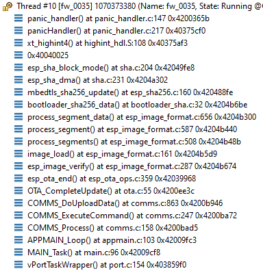

I’m adding OTA firmware update functionality over Bluetooth (BLE) and am having issues where calling esp_ota_end() constantly causes a panic. I have had this working previously during development. There seems to be no issues with starting the update and writing the chunks of firmware to flash. I have tried erasing the flash (using idf.py erase-flash), thinking that maybe something corrupted it somehow, but that didn’t help. I have also tried reading the firmware file from an SD card instead of over Bluetooth and get the same result.

Here is what my stack looks like after the panic. Seems to be something to do with verifying the firmware image?
Screenshot 2023-07-11 165445.png (22.75 KiB) Viewed 5534 times
Does anyone have any ideas on what could be causing this?

Hm. What I can see is that the panic is called by highint4, which is hooked up to the cache error handler and the interrupt watchdog. The first triggers when cache access is done while the cache is unavailable, which typically happens when writing the flash. The second is done when interrupts are disabled for too long (e.g. when an interrupt handler gets stuck). Without seeing the output of the panic handler, it's a bit hard to see which of the two it is.
You have a debugger attached, right? Can you check what the EXCAUSE register value is in the panic handler?

Checking with the Eclipse debugger, EXCAUSE is set to 4, which I guess is the latter of your two points (Level1InterruptCause). Just to see if it would change anything I increased the interrupt watchdog timeout to 10 seconds, but that didn't have any impact. Let me know if there's any other info you'd like to see. The INTERRUPT register is set to 10000000011001000001100000 if that's of any use.

Interesting, that reason seems to be PANIC_RSN_MEMPROT but the level-4 interrupt handler never sets EXCCAUSE to that value. Just to verify: what ESP-IDF version are you using? Possibly something changed between versions.

I encountered with this issue too (ESP IDF v5.1-dirty, ESP32-S3-WROOM-1 N4R8). I have http handler for OTA update (simple rest server). Write operation works successfully. But when calls esp_ota_end app panic by WDT. I goto esp_ota_end and added debug prints. I detected that app panic at:
   # in esp_ota_ops.c file at function esp_ota_end
   if (esp_image_verify(ESP_IMAGE_VERIFY, &part_pos, &data) != ESP_OK) {
        ret = ESP_ERR_OTA_VALIDATE_FAILED;
        goto cleanup;
esp_image_verify calls panic by WDT.
I tried to comment out block of code above (in the component source file), but panic was call again at function esp_ota_set_boot_partition, in my code.
My firmware image size is 1.5Mb
