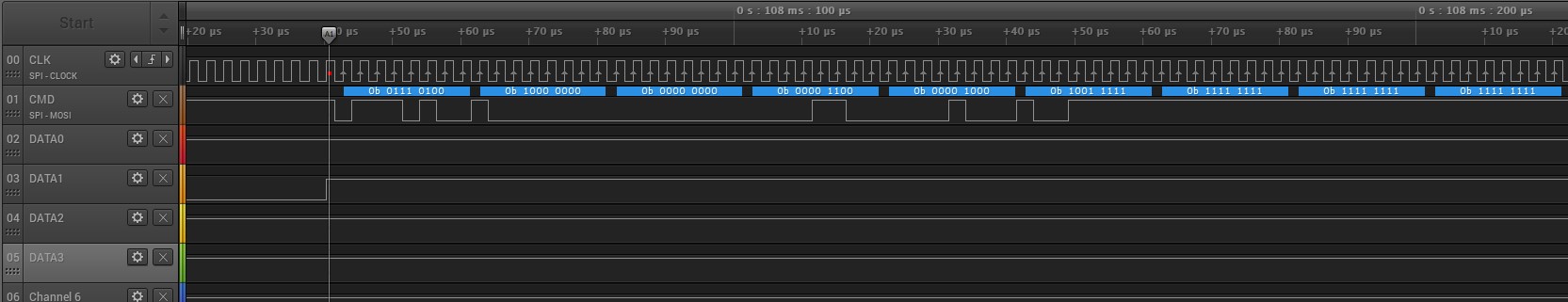

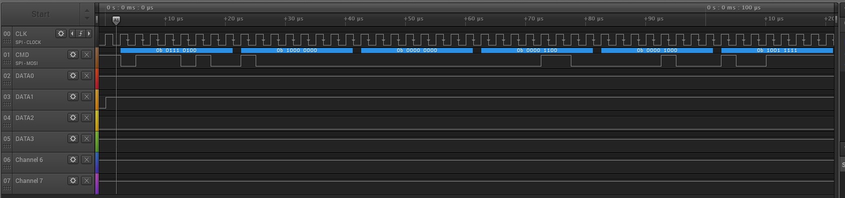

- stm32 as host timings
- stm32-esp32.jpg (109.55 KiB) Viewed 11399 times
- esp32 as host timings
- esp32-esp32.jpg (116.33 KiB) Viewed 11399 times

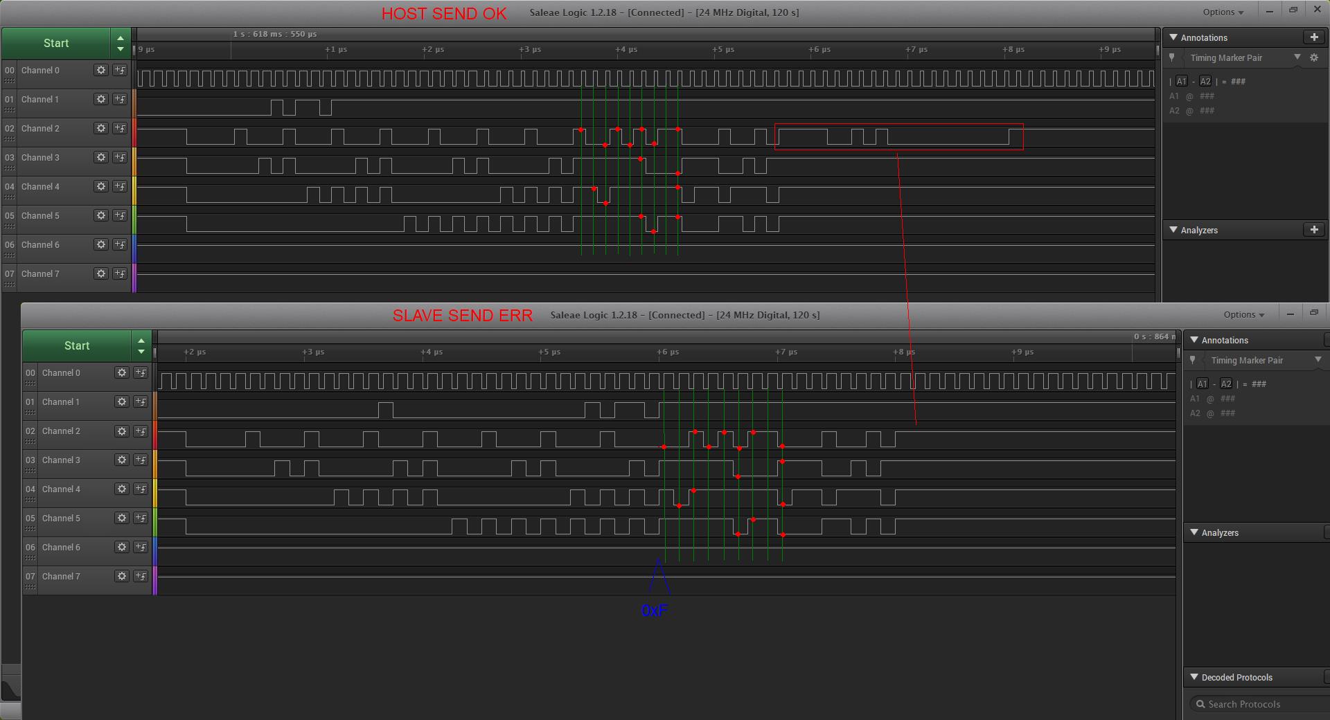

Re: SDIO slave. How to change timings?
Hi to all.
Sdio slave->host really work abnormal. I got standart example and some modified:
My buffer
when I send 8 and 16 bytes (depend to freq 24 or 16MHz) all ok, but when I send
more than 16 bytes - data is corrupted and error is occuried.
I think that hardware or low level has error.

- Posts: 37
- Joined: Mon Aug 28, 2017 10:25 am
Hi DiEitch,
Can you check whether your SDIO can work in 1-bit? (note, all the pullups should be left as-is, i.e. D1-D3 should be kept high if not used)
Seen from the picture, the slave may ignore one of the clocks. This is possible to be caused by the SSN when all the data lines changed from 1-0 or 0-1. This is move possible to happen in 4-bit mode.
If this is the reason, please add more grounding wires between the host chip and the slave. (slow down the frequency may not help)
Besides, can you show me the address you sent to the slave in CMD53 when you are reading 32 bytes? The slave only outputs a specified length of data according to the address.
Michael.
Michael.

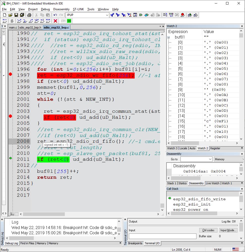

About my fifo rx function:
int esp32_sdio_rd_fifo(void)
int ret;
u16 sz;
ret = esp32_sdio_get_pktlen(&sz); //OK
if (ret<0) ud_add(uD_Halt);
if (ret<0) return ret;
ret = sdio_memcpy_fromio(&sdio0, buf81, FIFO_ADDR-sz, sz);
return ret;

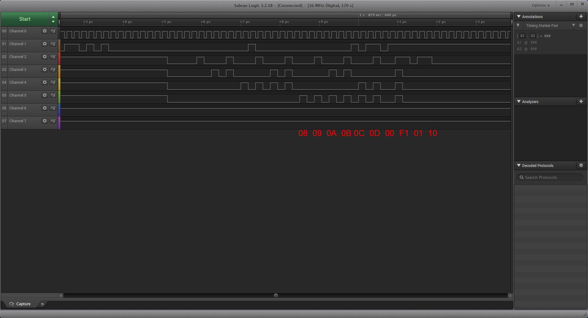

Hallo Michael.xiaoxufeng wrote: ↑Thu May 23, 2019 5:26 amHi DiEitch,
Michael.
About GND, I tried to add conductors, but no changed anything...
I compared the host and the slave transaction (16 bytes 0x0...0xF).
You was right: missed 1 clock and 0xF data!
Instead byte15/tetrade2 slave begin to send CRC.
How to fix it?
With the best regards.
