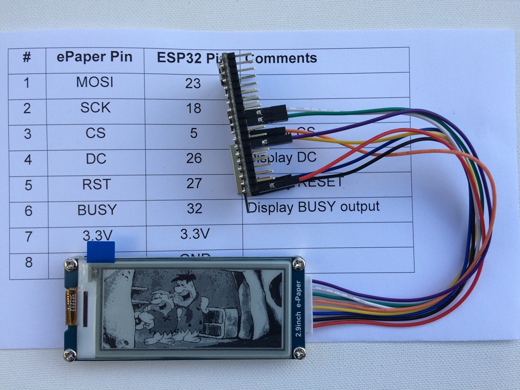

Tested on Waveshare 2.9" ePaper module connected to SparkFun ESP32 Thing board.
http://www.waveshare.com/wiki/2.9inch_e-Paper_Module

krzychb
Posts: 425
Contact:
Re: ESP32 ePaper display library
Postby krzychb » Sat Aug 05, 2017 5:10 pm
Hi @loboris,
Thank you for this great component and comprehensive demo.
As usual with your applications I got it up and running in no time.
ESP32 with ePaper display
ESP32 with ePaper display.jpg (274.12 KiB) Viewed 33773 times
This should be a great solution for battery powered projects.
