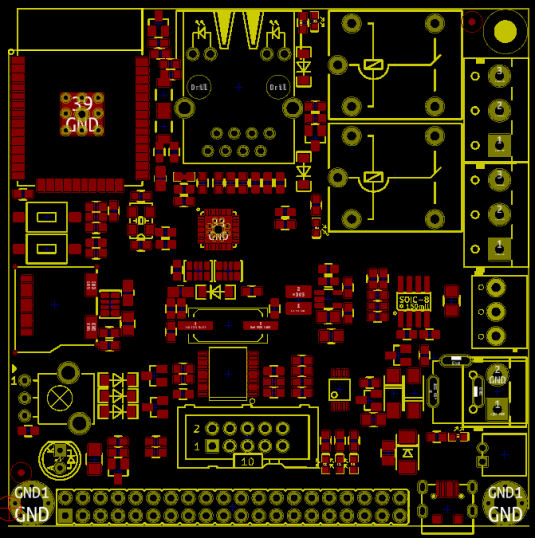

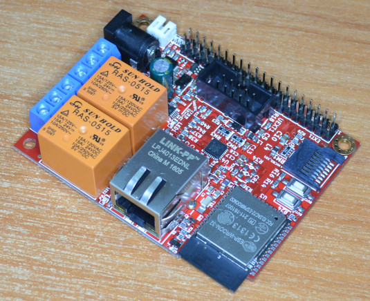

hi guys
olimex new ESP32-EVB board for IoT first prototypes are spotted here and here
it comes with nice parts
ESP32-WROOM32 module
two relays 10A/250VAC
Ethernet 100Mb interface
LiPo charger and step up converter allowing ESP32-EVB to run from LiPo battery
microSD card connector
two user buttons
UEXT connector to attach different sensors and modules
40 pin GPIO 0.1″ step connector with all resources of ESP32
5V power jack
three mount holes

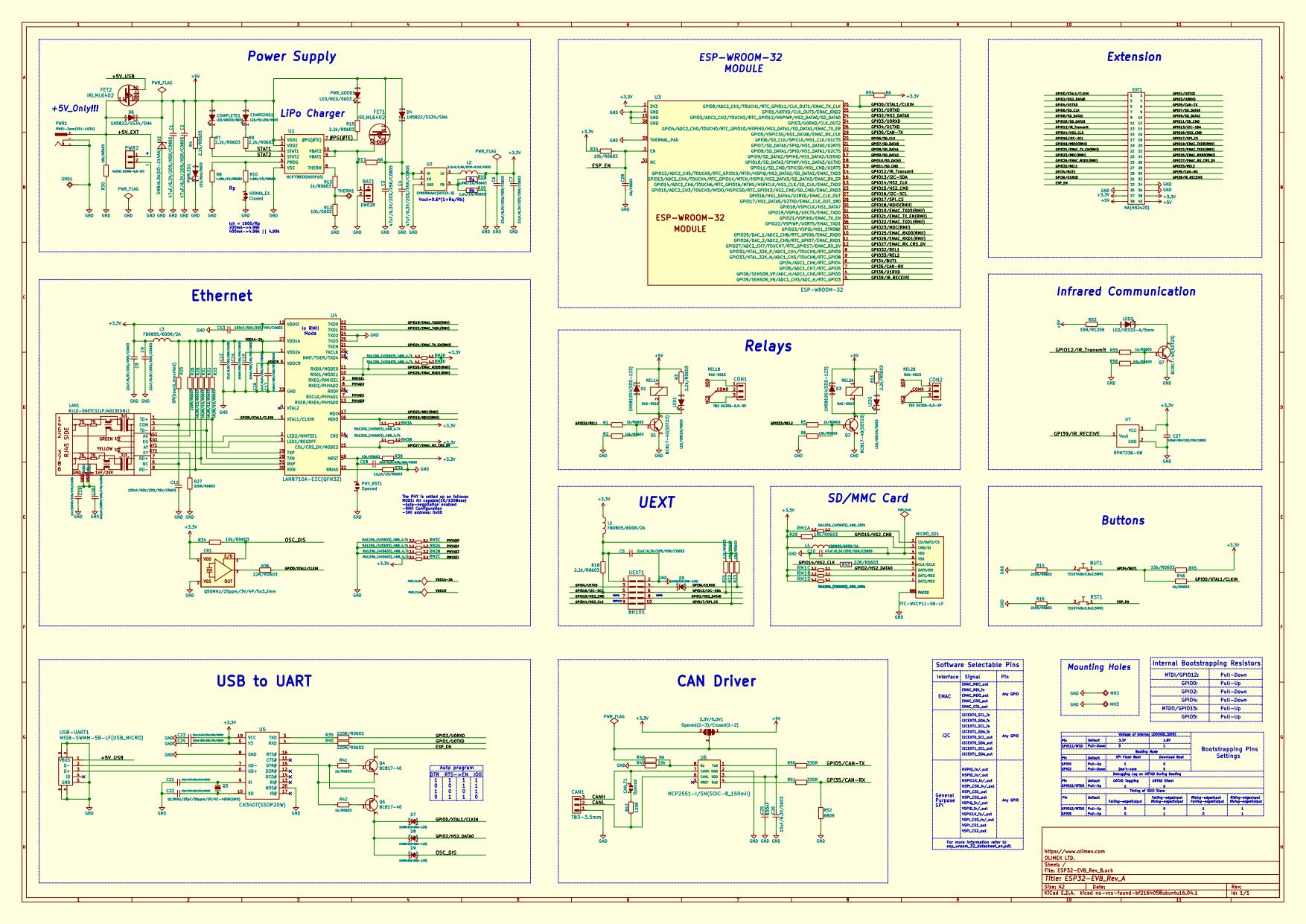

push:
BOM, Gerbers, Board Shema, and others on github
( click on the pic for shema as pdf at github )
[/url]

Postby igrr » Fri Feb 10, 2017 10:21 pm
Interesting design! I wonder how will sharing flash pins with the SD card work in software.

Postby igrr » Fri Feb 17, 2017 12:02 am
One possible way to have SD card on the same pins as SPI flash would be to put all SD card related functions into the IRAM, then disable flash cache each time we do SD request, then reenable flash cache again.
In practice this means placing most of the SD driver functions into IRAM. This may take quite a bit of IRAM. As a first approximation, you can try marking all functions inside sdmmc_host.c as IRAM_ATTR and then disable/enable cache in sdmmc_host_request.
Regarding the second question about Ethernet clock output, be sure that we saw your question, and we'll let you know as soon as we figure this out. IIRC, we may have to use the APLL to generate the 50MHz clock for the Ethernet.

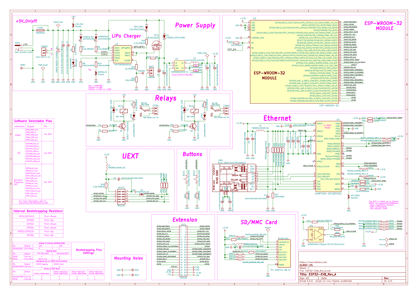

Postby rudi ;-) » Thu Apr 06, 2017 7:18 pm
olimex updated ESP32-EVB to REV-B:
append
- CAN
- Infrared transmitter and receiver
- on-board programming
- LCD2.8" on UEXT to come soon
(click on the pic to zoom a higher resoltion )
[/url]
more infos
