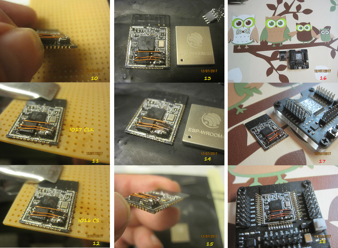

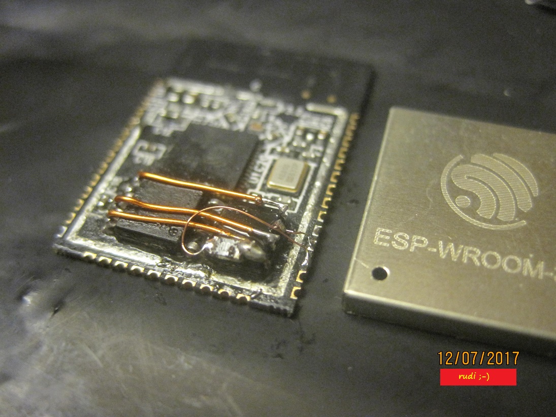

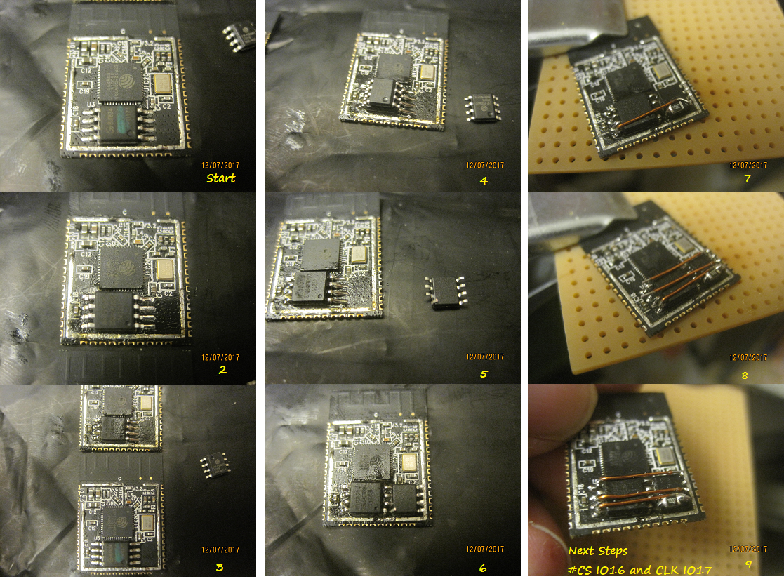

Wroom32 free hand pimped Version
128Mbit Flash as far as it went to the left pushed
PSRAM turned upside down and to the right of it
used here:
WROOM32 standard modul
pimped with:
Flash: Winbond 128Mbit 1.8V
pSRAM: ESP-PSRAM32 ( espressif )
it fits horizontal and vertikal.
the next gets wire 0.1 / 0.05 mm
the next step follows
there comes a "custom" Wroom32 factor modul with Wrover insides asap :), up2dates follows next time
steps 1-10
steps 11-18

in this simple step, only one Flash and only one pSRAM so :
Flash side is 128Mbit, so there are 16Mbyte on Flash1 for saving files.
pSRAM side is 32Mbit, so there are 4Mbyte on pSRAM1 for pSRAM.
there are other further steps in the pipe and becomes public next time too.

the flash on the left has marked pin1, what is CE for the flash
then counterclockwise follows pin 2, 3, 4, 5, 6, 7, 8,
the pSRAM hast this pins too and on pic #5 you see the pin1 bent
on pic #4 you see the pSRAM normal, on pic #5 turn it upside down

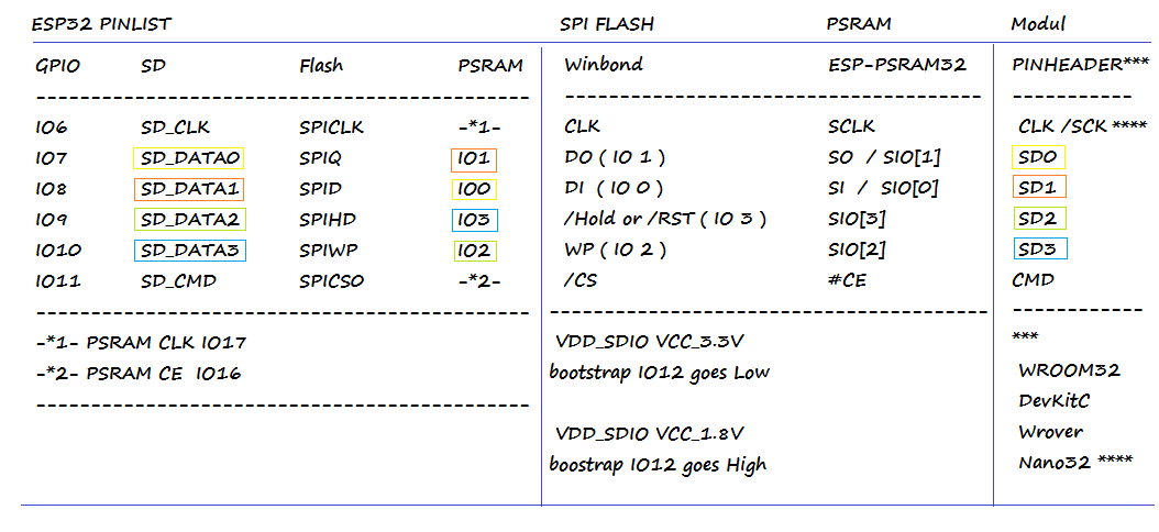

the psram goes to this pins of Flash too
only pin1 CE goes then to IO16 and pin6 CLK goes then to IO17.
cause we can save place, we do here the trick to
turn it upside down the pSRAM and can connect
pins 2, 3, 4 directly to the flash 2, 3, 4
psram pin1 ( CE ) goes to IO16
pic #12
then the pins 5,7,8 of pSRAM
goes again exactly to the same pins of flash
only pin 6 CLK goes then to IO17
pic #11

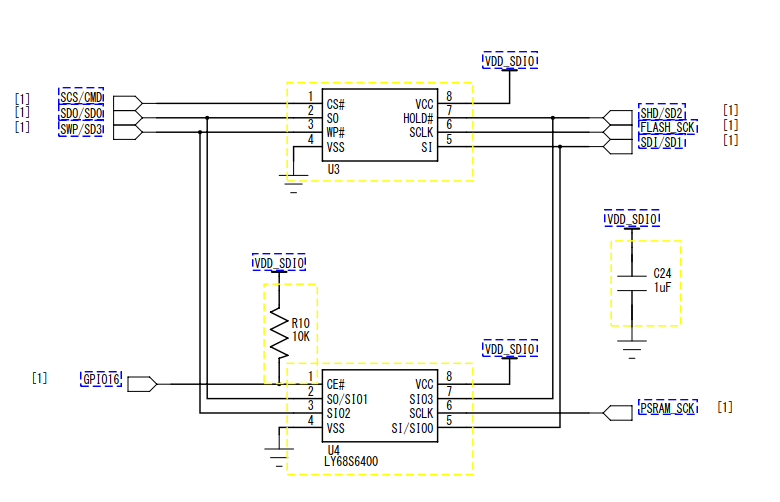

cause /CE ( pi1) from pSRAM is pulled up to VCC_Vdd_SDIO_1.8V (not 3.3)
between pin1 CE from pSRAM and ideally the VCC pin 8 from pSRAM there is a 10k Ohm resistor
so you have 2 connect points on the pin1 CE pSRAM then -
- resistor left point
- IO16
and 2 connect points on the pin8 VCC pSRAM then
- resistor right point
- VCC_VDD_SDIO_1.8V
you see this detail on pic #15

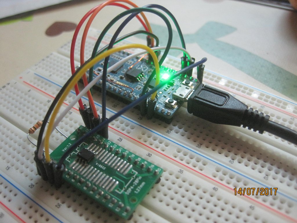

nice shematic you see here in this post

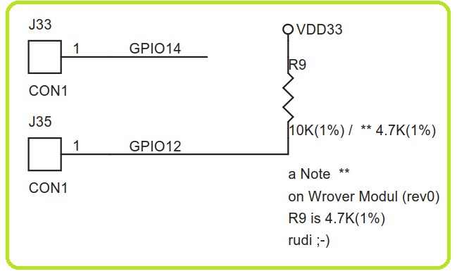

in final ( solder on a breakboard or adapter or anything,
one step you must do further: bootstrap MTDI pulled up cause 1.8 VDD_SDIO:
you must set the bootstrap pin MTDI ( IO12 ) pulled up
you can do this by efuses too but from here it is suggest
to do this by bootstrap pin.

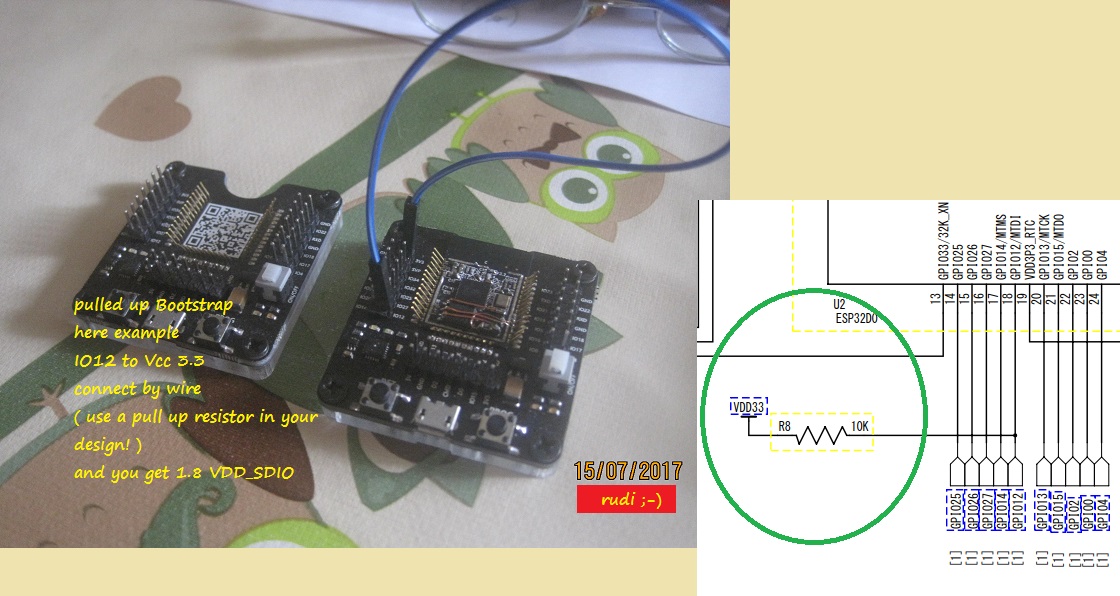

other mod example DevKitC
there is Wroom32 mouned too, and you see the bootstrap connect then on the
DevKitC like this

last but not least:
if you plan to connect by pinheaders on the moduls and pSRAM on a breakout adapter
be sure your line are not to long because we have 40MHz on SPI
so if you wounder, why not all is running then, it can be the reason for it.
also note this then:
if you plan MP on it
be sure your PCB design follows the High Speed rules
or you get noises and your mod is not run.

@eros
if you use the "engineering" adapter for wroom32
then you can pull up the bootstrap by wire
on this pinheader for testings simple IO12 goes to VCC3.3
!!! not sure what your end design is and how you use IO12 later,
use please a resistor between this lines! 10K do the job.
