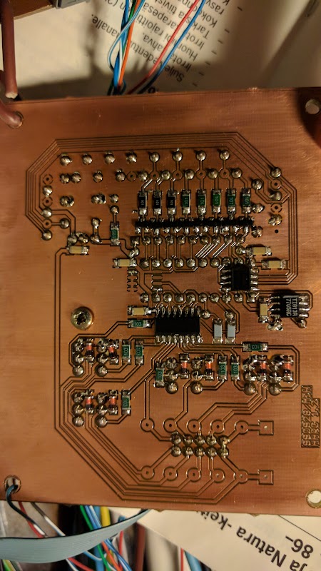

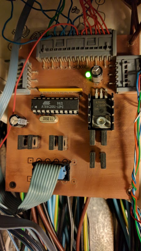

I'm new in this forum so brief introduction is in place I guess... I've been doing electronics & programming 35+ years, and currently quite deep in JavaScript full-stack world.
My house, which was built 19999, is kind of "smart" having 24V relays controlling all lightning and 2/4 push-buttons in every room. Relays are DIN rail types in our double cabinet "fuse wall", and there is three DIY relay cards each with 8 inputs and 8 pull-down outputs.
So it's 18 years to date and still haven't completed the "smart" part of my system, and then found ESP32 & this forum!
Got so excited that immediaterly ordered two ESP-WROVER32 ESP32 modules, one "quick burn" module and some more HW for getting in speed with this.
My target is to prototype with I2C connected IO submodules to replicate current functionality, then enter to "smart". Modules will be built using MCP23017 and using other 8-bit bank for inputs and other for 8 relays. Haven't yet found good enough (and cheap) open relay driver having this nice chip thus it's time to DIY schematics & layout for these boards.
What comes to software, let's see how far I can go with JavaScript, but likely need to code submodules controlling code using C. Then I'll do my best to port GunDB to run under Duktape control, and map that to input events and control outputs.
So, awesome job this far, and let's see how far beyond Duktape in ESP32 can go...
