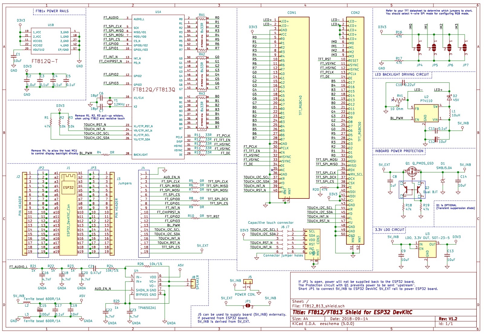

So, what a good way to start after switching to KiCAD?

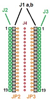

Design a board long due on my list - FT81X shield for an ESP32 DevKitC.
This will support both FT812 and FT813. Differenc is that FT812 supports resistive touch, the FT813 supports capacitive touch.
Attached below you can see the schematic. Layout is next, with lots of footprints to make. :ugeek:
Couple of words about the board:
- Board will feature solder holdes for 2 rows of socets to accept DevKitC plugged directly to the board. (J3)
- right next to these sockets, (underneath the DevBoard) would be 2 rows of 100mil standard holes connected to the sockets. These wilfunction as solder holes so you can solder jumper wires.
- In the middle of all this, still underneat the ESP32 board, there will solder hole stip, routing all the important signals. You can use these to jumper each signal from the shield to the DevKitC by soldering. This would allow full configurations on the signal routing.
pins and jumpers sketch.jpg (28.21 KiB) Viewed 13972 times
For TFT connection, there will be 2 FPC connectors. CON1 is a standard 40pin 0.5mm pitch RGB screen connector, and a 6pin FPC connector for the Capacitive touch screen.
The other is a 50pin connector, to connect displays with SPI interface, like ILI9341, or ILI9488. SPI lines needed for these screens are shared with the FT81x's SPI Bus.
Looking forward to any input on this schematic.

Adding an audio amplifier connected to FT812/FT813 audio output could be useful (possible with a speaker onboard).
BTW, why not use ESP32-WROOM/ESP32-WROVER module instead of ESP32 DevKitC socket and make a complete standalone graphics board?

The reason is quite simple: I wanna make this thing as simle as possible, with minimalistic BOM, easy assembly.
I don't want to spend more work with this yet until the software is figured out, for which this board is totally enough.
Audio was not a key design goal, as (as far as I know) it is pretty poor quality on this chip.
If someone needs audio they probably have something external.
On this note however I will add a connector for audio, thanks for the headsup on this!
Adding a WROOM or WROVER means adding USB, Reset circuit, etc, basically design a DevBoard onto this board.
This board just has the FT chip, a dozen caps and resistors. The most difficult parts being the LED driver circuit, and the Inboard power protection circuit(This protection circuit is optional, I stole the design form the RPi ;) ).
The BOM is pretty simple, and easy to buy parts.
It's a shield, hence it's made for being highly configurable.
I'll make this so that most parts could be soldered in with just soldering irons. (I will design the board in a way that the exposed pad under the FT chip will be exposed to the other side through vias, so you can flow the solder in with an iron.)
I planned on sending a soldered up board to you anyway, since you are a TFT expert amongst us, and most TFTs you can buy from Buydisplay will fit the 50pin connector :P (I guess you have these screens lying around)
Later when I figure out how the software and hardware can play together I might make a second board, with things more fixed to pins rather then jumpers.
Right now the goal with this thing is to not make something compact and ready, but to give a design to people that they can easily put together to experiment with.
Anyways, you can just solder the DevKitC directly in, which would make it pretty compact, and most people have these Devkits lying around in a bunch, and they don't cost more than a standalone module.

To inhibit the voltage I layout jumper pins directly in front of the devC board usb connector with a tall jumper :D . The jumper physically prevents inserting a usb cable but connects internal power when installed. Remove for development. If that is what that rpi circuit is for.

Less is sometimes more :D But I just wanna have it there and let the user decide to use it or not.

After suggesting, I included an audio circuit into the Schematic. First post updated.
