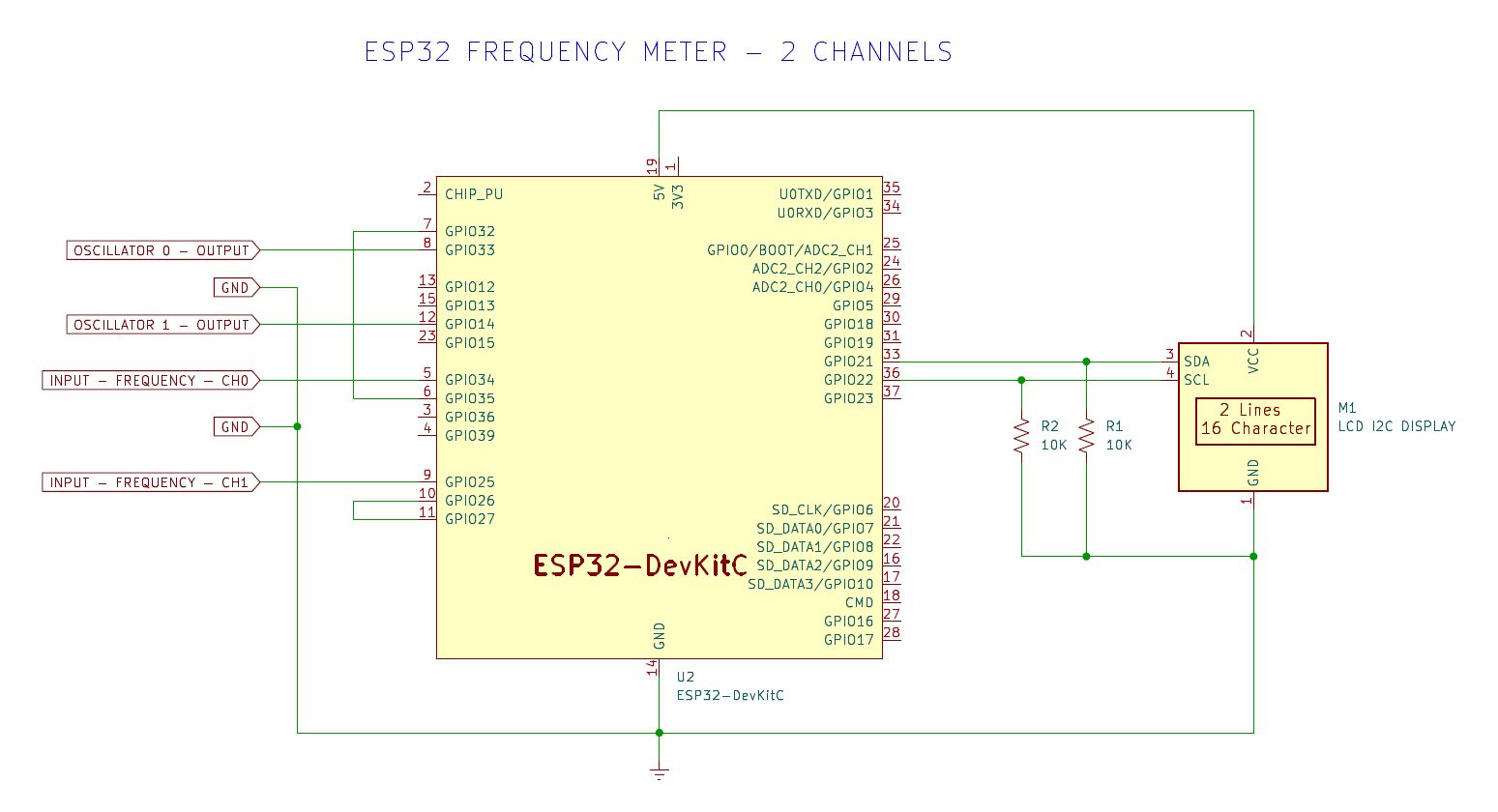

ESP32 FREQUENCY METER - NEW VERSION:
For the happiness of those interested in the project, I am posting an update to the code and schematics.

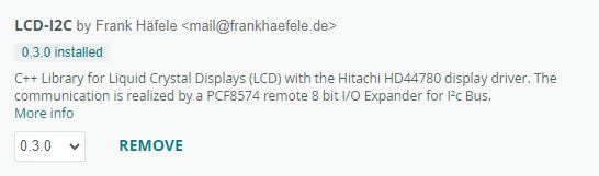

I chose another library for the LCD I2C Display. Simpler and functional with the new ESP32 firmware.
I removed the option to connect directly to the LCD, as it was confusing for some.
I changed the inclusion of some ESP32 libraries, to make them compatible with the new ESP32 firmware.

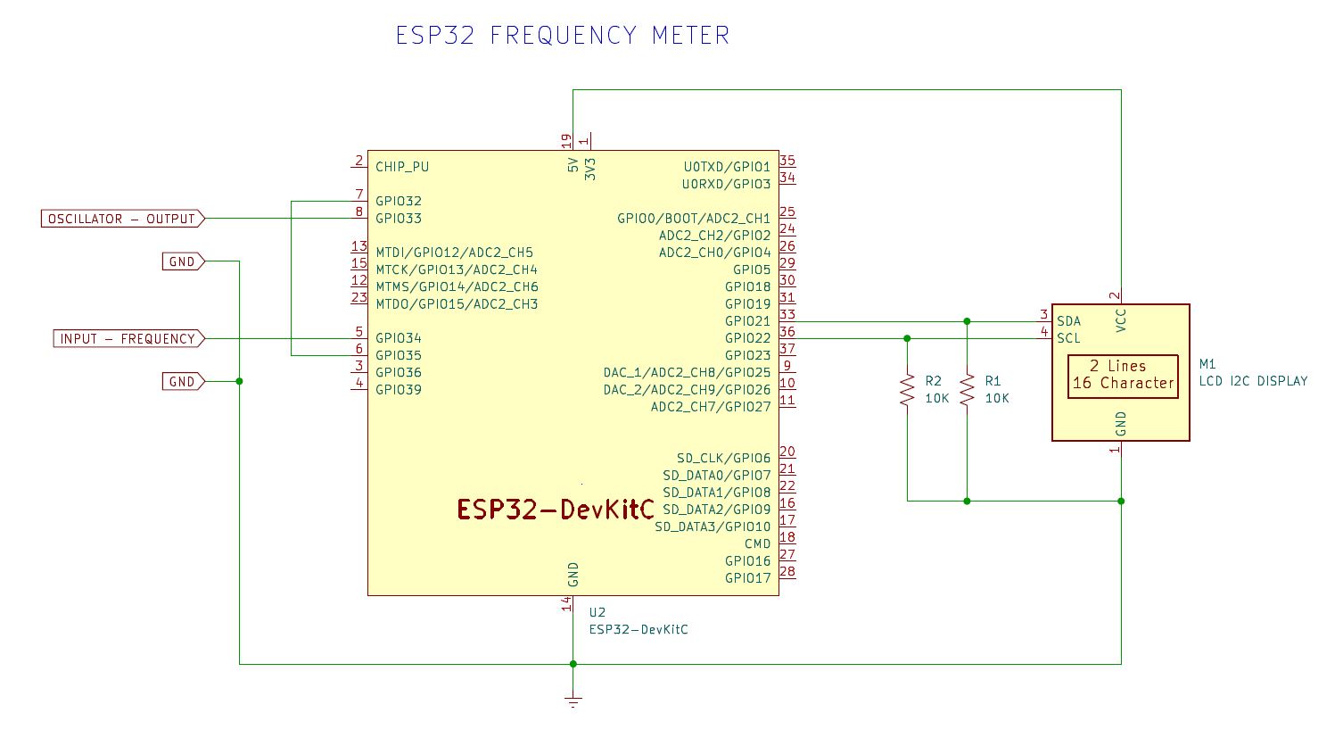

Connect the oscillator output to the frequency meter input to perform tests.
Use the serial console (Arduino IDE - 115200 bps) to change the oscillator frequency for testing.
Use resistors R1 and R2 to equalize the voltage level on the I2C bus to 3.3V used in ESP32.
If you are in doubt about the I2C address of your I2C LCD module, use the I2C scanner.
ESP32 - I2C Scanner using Arduino IDE
viewtopic.php?f=18&t=4742
Add this library using the Arduino IDE library manager
https://github.com/hasenradball/LCD-I2C
LCD I2C library.JPG (14.99 KiB) Viewed 10943 times
ESP32 Frequency Meter
ESP32 DevKit 38 pins + I2C PCF8574 LCD
Arduino IDE 2.3.2 / ESP32 Arduino V 3.0.2
Gustavo Murta e Rui Viana august/2020 - updated 2024/07/19
Github - project Frequency Meter 2024
https://github.com/Gustavomurta/ESP32_f ... Meter_2024

Schematic in PDF for download:
ESP32_Frequency_Meter.pdf
(74.84 KiB) Downloaded 333 times
ESP32 Frequency Meter 2024.JPG (101.63 KiB) Viewed 10943 times
Open this image in another page in your browser to view at a better size.

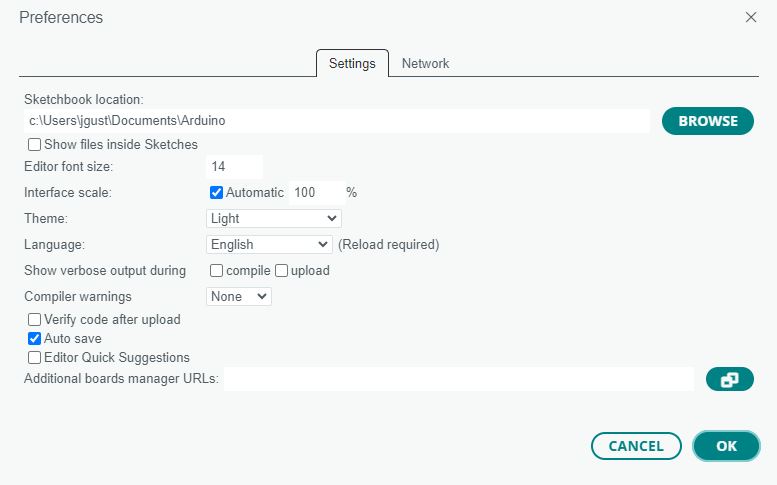

I suggest you use the same version of the Arduino IDE and the new ESP32 firmware as the updated project, to avoid the errors you are encountering. And of course, use the new updated sketch. Here at home, everything has been tested and working!
1) Arduino IDE version 2.3.2
https://www.arduino.cc/en/software
2) ESP32 Arduino V 3.0.2 - Install via Board Manager - This way you won't need to add links to the IDE preference!
it is not necessary = in "File/Preferences/Additional board manager URL's" add these lines.
ESP32 ide arduino.JPG (21.94 KiB) Viewed 10796 times
Arduino IDE installed in my PC:
IDE prefernces.JPG (32.22 KiB) Viewed 10796 times
Look! Error-free compilation!

ESP32 FREQUENCY METER - 2 CHANNELS:
I am posting now an upgraded version with 2 channels - under development!!!
There is still a problem with the program - the interrupts of Pulse counter 0 is interfering with the interrupts of Pulse counter 1.
This causes the program to crash, if frequencies are greater than 16,000 Hz. Test both channels of the frequency meter with frequencies below 15999 Hz, only for now.
Maybe the solution is to configure the interrupt priorities of the two counters, but this is only allowed in the new drivers for PC Unit.
I think that to use this new driver version, I will have to make several changes. I am researching a solution.
I implemented a variable for calibrating measurements (offset)- calibrator => calibrator of frequency reading (may be + or - integer numbers).
Connect the oscillator outputs (0 or 1) to the frequency meter inputs (CH0 or CH1) to perform tests.
Use the serial console (Arduino IDE - 115200 bps) to change the oscillators frequency for testing (same frequency in the both channels for while).
Add this library LCD-I2C using the Arduino IDE library manager
Github Project:
https://github.com/Gustavomurta/ESP32_f ... _Meter_2CH
ESP32 API references used in this project:
https://docs.espressif.com/projects/esp ... /ledc.html
https://docs.espressif.com/projects/esp ... timer.html
https://docs.espressif.com/projects/esp ... /pcnt.html
Arduino Code: ESP32 Frequency Meter / 2 Channel - Version 2
ESP32 DevKit + I2C PCF8574 LCD
Arduino IDE version 2.3.2 / ESP32 Arduino Version 3.02

Schematic to download:
ESP32_Frequency_Meter_2CH.pdf
(77.66 KiB) Downloaded 262 times

NOTE: I used a pin extender underneath the board to be able to fit it into the Protoboard.
ESP32 Freq Meter 2CH board.JPG (167.34 KiB) Viewed 10015 times

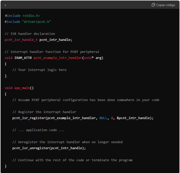

I didn't understand how to use the "pcnt_isr_unregister" function. And with the help of ChatGPT Artificial Intelligence, everything became clear.
ChatGPT ESP32 unregister ISR.JPG (49.6 KiB) Viewed 9734 times
(77.66 KiB) Downloaded 294 times
